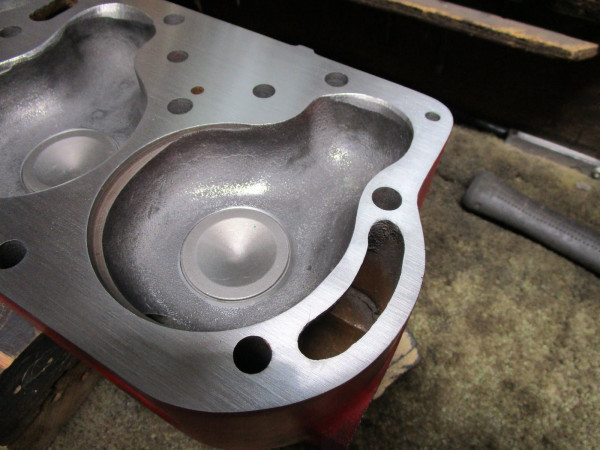

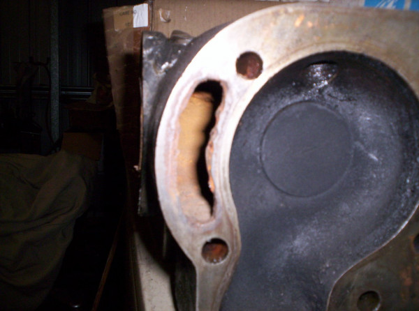

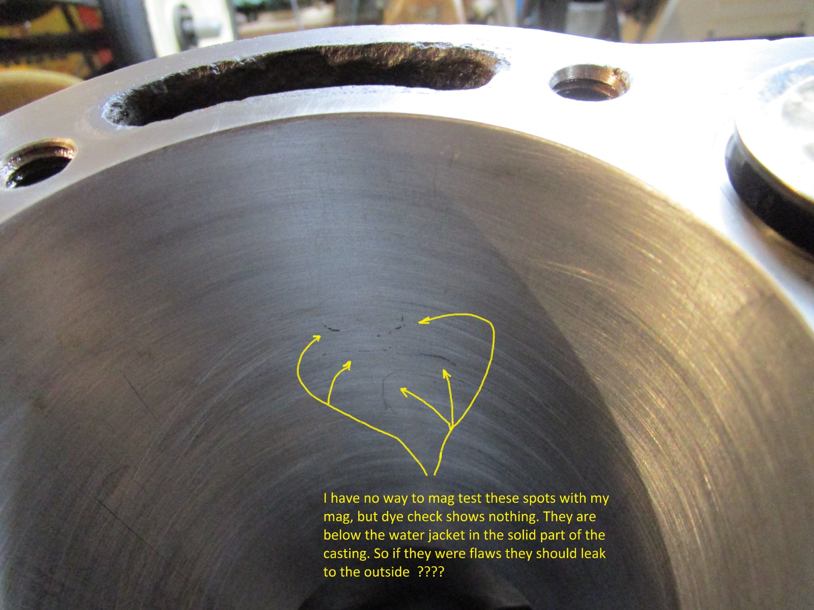

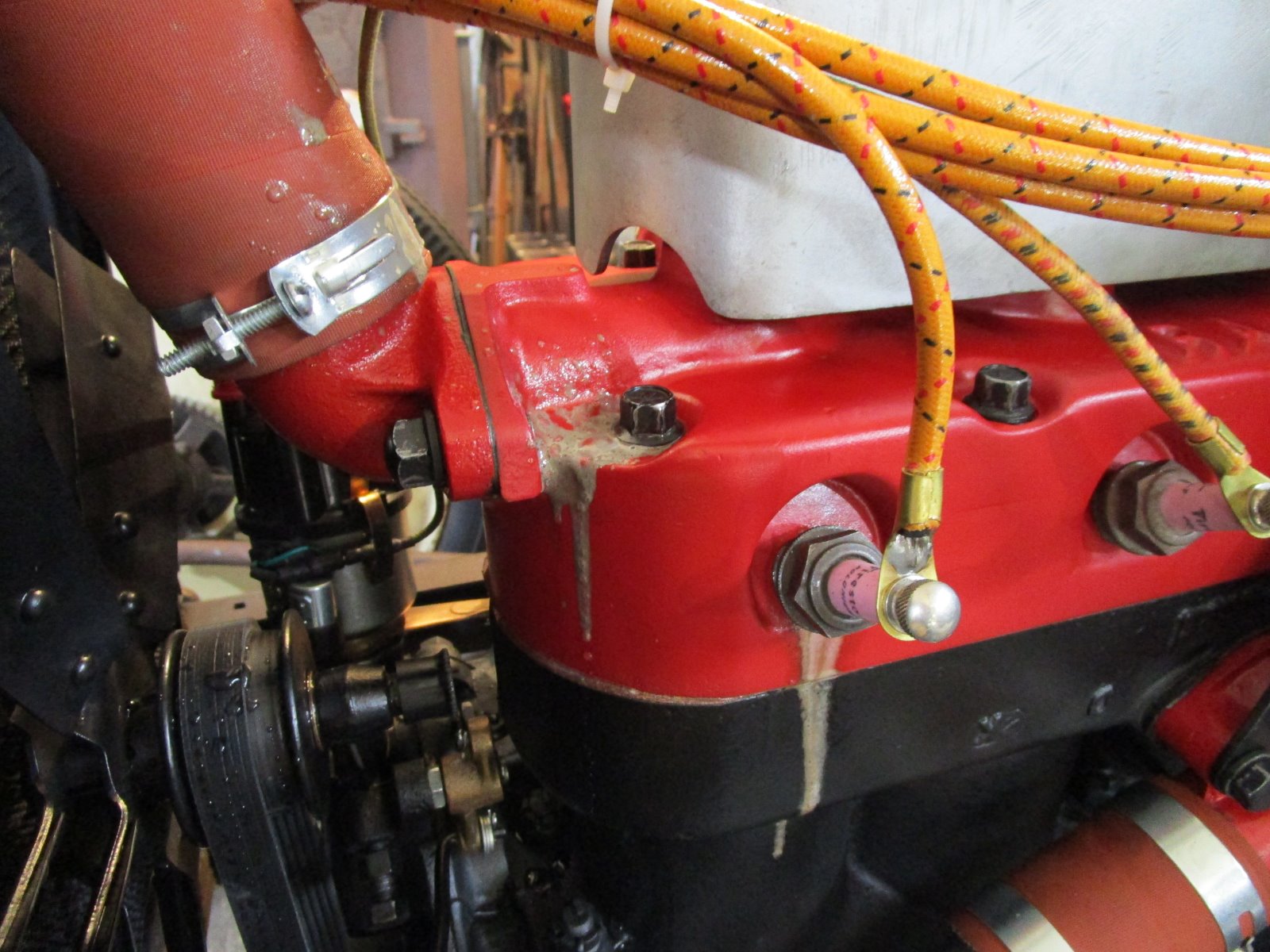

Well I finally got the engine back together and installed after the last head gasket leak and major crankcase gasket failure. I have the oil leak stopped but the head gasket did not seal again. It started leaking immediately after start up. IT is in the same place as last time. It is leaking between the front two head bolts. I did a re-torque after a couple minutes run time and then let cool. The torque did not change any. So I pulled the head to see what is going on. Like last time I can not see anything that should cause a failure. I am almost positive that it is leaking between the two front head bolts. I will post a picture of the leaking area. In the pictures you can see oily water coming from around the head bolts. That is about 15 seconds run time of leak. It was actually "blowing" water out the head bolts. I did not have the spark plug tight enough is why it is also leaking at the spark plug. It put water into the oil in just a couple minutes. When I removed the head there was water on top of the piston. So the leak is a "big" leak

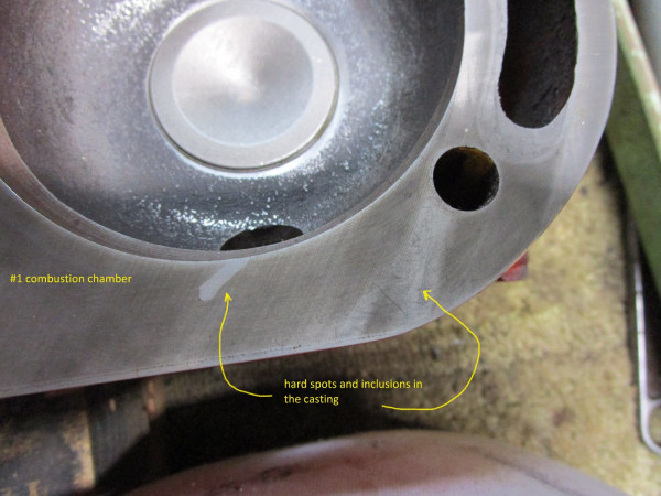

The only issue I can even come up with is the machining of the head may be bad. I had the head decked during the original rebuild. When I look at the machined head surface I can see what appears to be "hard spots" in the casting. Maybe the surface milling machine at the machine shop had some wear and the hard spots caused the cutters to deflect. ???? Using my machinest straight edges, I can not really detect anything. But my accuracy is probably only good to about .002 thou.
I have pulled the engine again, so I can get to everything easily. I plan on having the head re-surfaced again. But I need to locate someone who can machine the "hard spots" without deflecting. I may contact the Blanchard grinder I used in Little Rock to surface my KR Wilson pan jig. His Blanchard grinder is supposed to be accurate to a 1/2 a thou for the full 8 foot length of the table. But they may not do small heads. I also found a place that does "production" re-surfacing of heads with a "belt grinder" type of machine. I know nothing about belt type machines so any input is appreciated.

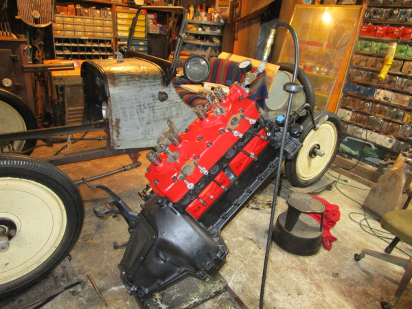

I am building a engine test stand. I do not want to put the engine back in the car till I have it running good. It is a %#$@% removing the engine. I need a test stand anyway, so now is as good a time as ever to build it.
I would like any comments as to possible scenarios on how a leak like mine could happen. My thoughts are
(1) It has to be in #1 cylinder
(2) It could be poor seal of head gasket between the two front head bolts on the cylinder side.
(3) It could be a crack in cylinder wall into water jacket (but I do not see how it could come out the head bolt holes)
(4) It could be a crack into the bolt holes from the cylinder (but it would need to be cracked at both holes)
(5) It could be a crack or casting flaw in the combustion chamber into the water jacket (again I do not see how it could leak at the bolt holes)
(6) If there was a crack anywhere in the combustion chamber/cylinder wall it should just leak into the water jacket not come out the bolt holes
I have dye checked and mag tested every inch of the front of the head and block. No indications at all. I can not get the mag down very far into the cylinder to check the cylinder walls. I would think any crack big enough to leak as bad as this is leaking should be visable to the eye. ???
The only good thing is the engine starts very easily and other than a dead miss on #1 it seems to run good ...
One other question, How much imperfections should a copper/asbestos type gasket take care of. Back when I was dumb and poor, I have put head gaskets on 60s 70s era Ford 6 cylinders with as much as .010 warp and the things held ....
Any input is appreciated.

My first thought was are the head bolts bottoming out before they should do to blockage in the holes?
Posts: 1685
Last Name: Seth
Location: Jefferson Ohio
Re: Speedster project update, blown head gasket (again)
Post by perry kete » Tue Sep 01, 2020 9:17 pm
Could there be debris in the two front head bolts holes not allowing them to seat?

Steve and Perry, I forgot to mention that all bolt holes were checked and measured during the original build. I also put the head back on the engine this time without the head gasket, just to re-verify the bolts . All the bolts would screw all the way down by hand with no head gasket.
I also checked the front two holes to make sure they are not drilled into the water jacket. They are OK.
I also forgot to mention that this is a Rajo 4 valve head.

Pressure check that head. You may be pressurizing your coolant system.

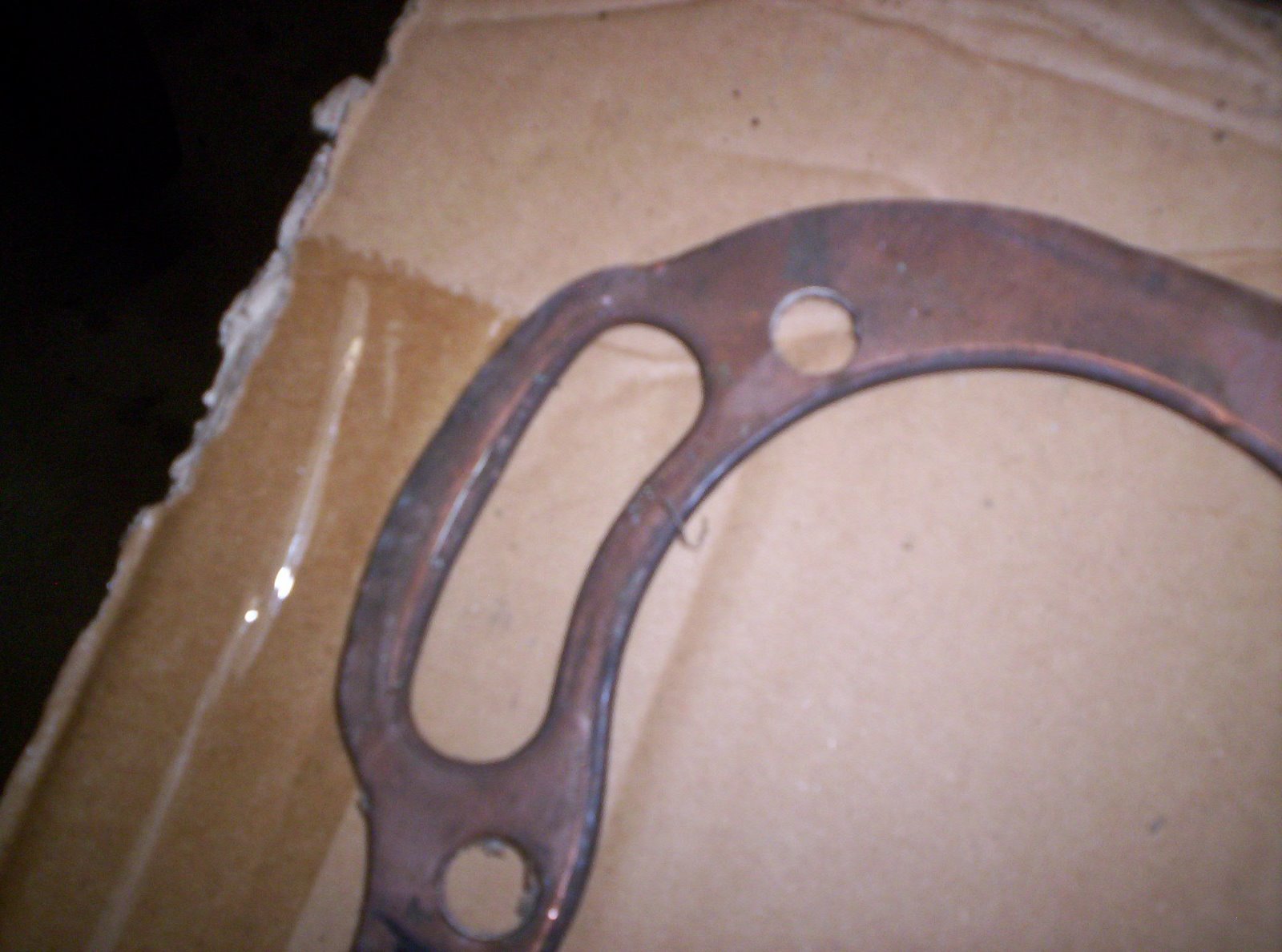

Hi Don, Are you able to post a picture of the block surface and also the gasket? That might help diagnose the problem. With the Rajo 4 valve there is a big space around where the old inlet valves used to sit. the gasket can compress into that hole a bit and deform the gasket which may cause a leak? I actually used some old valve heads with the center drilled out to take up the space where the valve used to sit to provide extra support to the gasket. I feel you pain removing that head as it is a pest to have to keep removing the rocker posts to take out those middle head bolts.

Might be of some help? photo's of a head and gaskets, heat ring is as close to the bolts as yours but the seal ring in the gasket water hole has more head surface to seal on than yours.

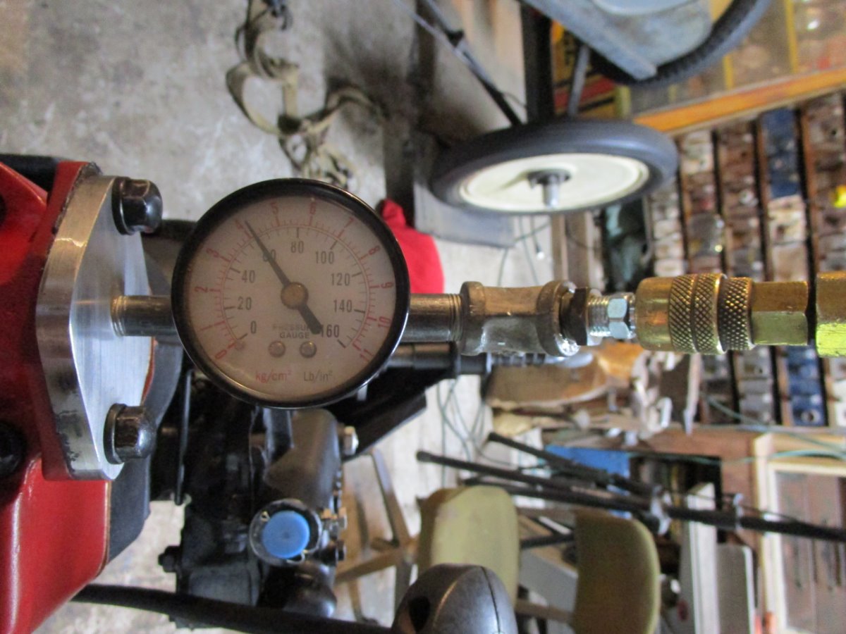

Donnie, After you get the engine stand built but before you take the engine apart try this. I assume you have made plugs for the old inlet valves that the push rods go threw. You could mount a stock T head and gasket and try cranking the engine over with the starter, you could even try hand cranking if you have to. You won't have any compression but you may be able to get the block to leak coolant if the problem is with the block. If that doesn't work to find the problem I would for sure have the head pressure tested and surfaced again. I don't think the problem is the head gasket. You didn't say if the head is cast iron or aluminum but it looks like iron in the pictures. Good luck, your speedster is supper nice.

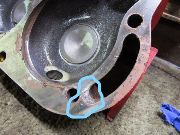

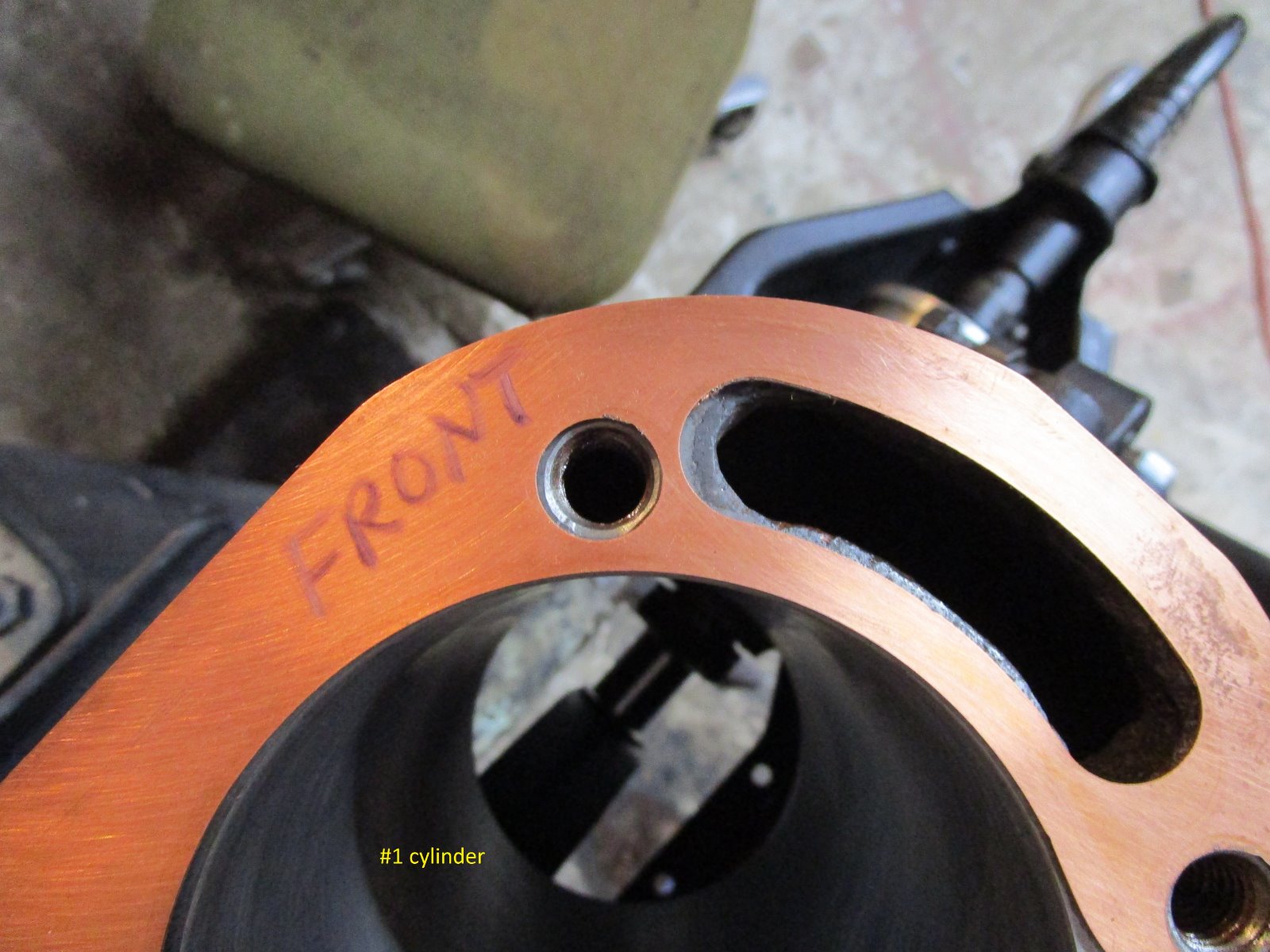

The heavy leak seems be coming from the area circled in blue;
Could this area be the issue? It looks lower then the rest of the surface. What about filling with JB Weld to build it up?

Post by dobro1956 » Wed Sep 02, 2020 11:46 am
Good morning, Thanks for the input. Ill try to post a few more pics this evening.

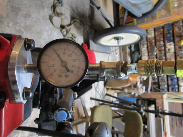

Ill try to make a seal plate with gasket to do a pressure test of the #1 combustion chamber in a few days, as suggested. A bad casting is something I thought about. But dye check and mag test shows no indications at all.

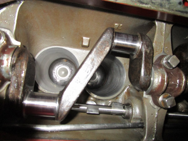

I have installed valve heads at the intake ports. When the gasket leaked the first time I thought They may have been too high, so I reset them making sure they were about .001 to .002 low. 4 valves are know to blow gaskets at the intake ports So some support is needed. I do not think my valve head supports are part of my issue.

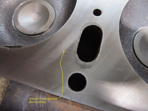

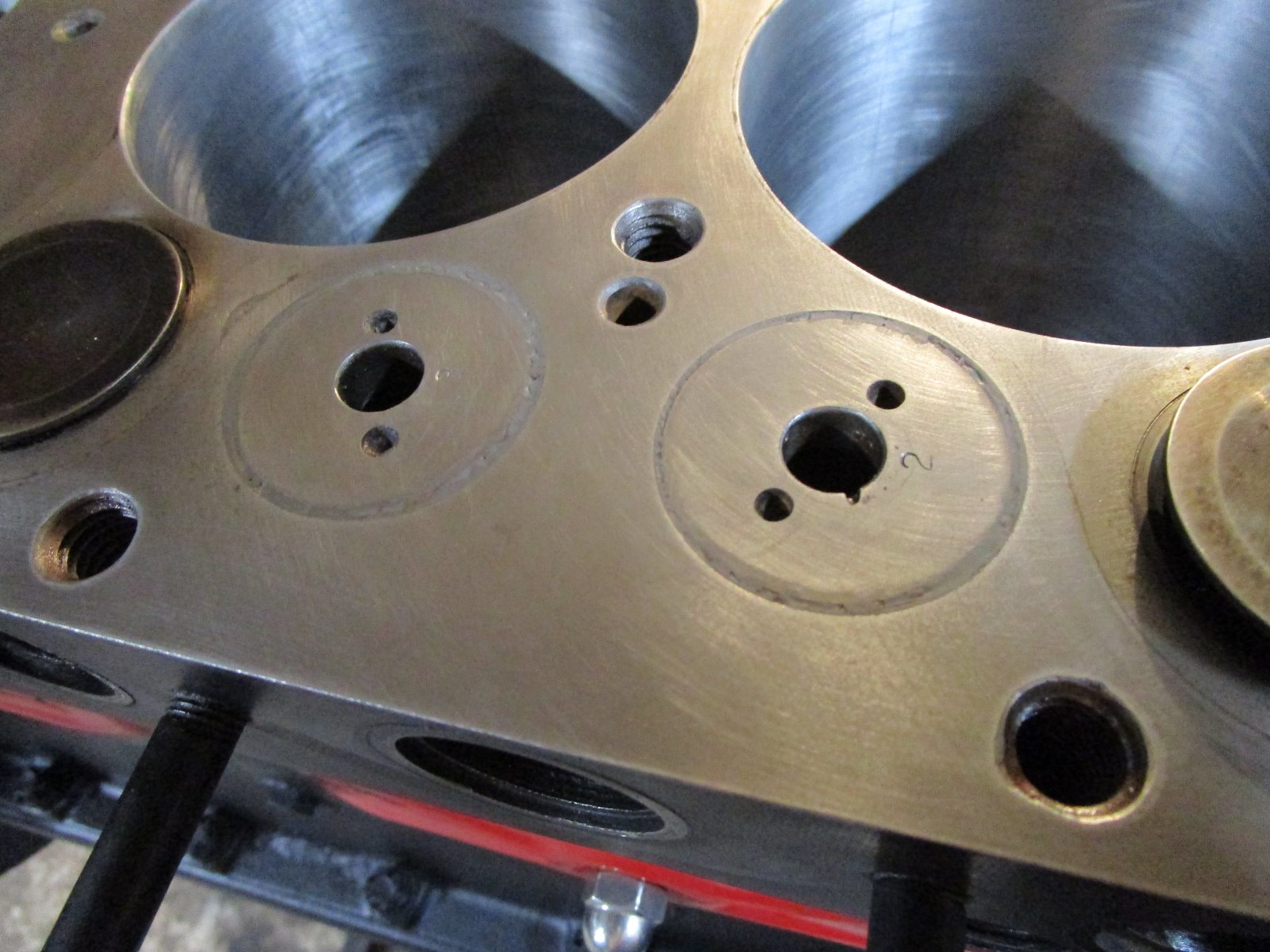

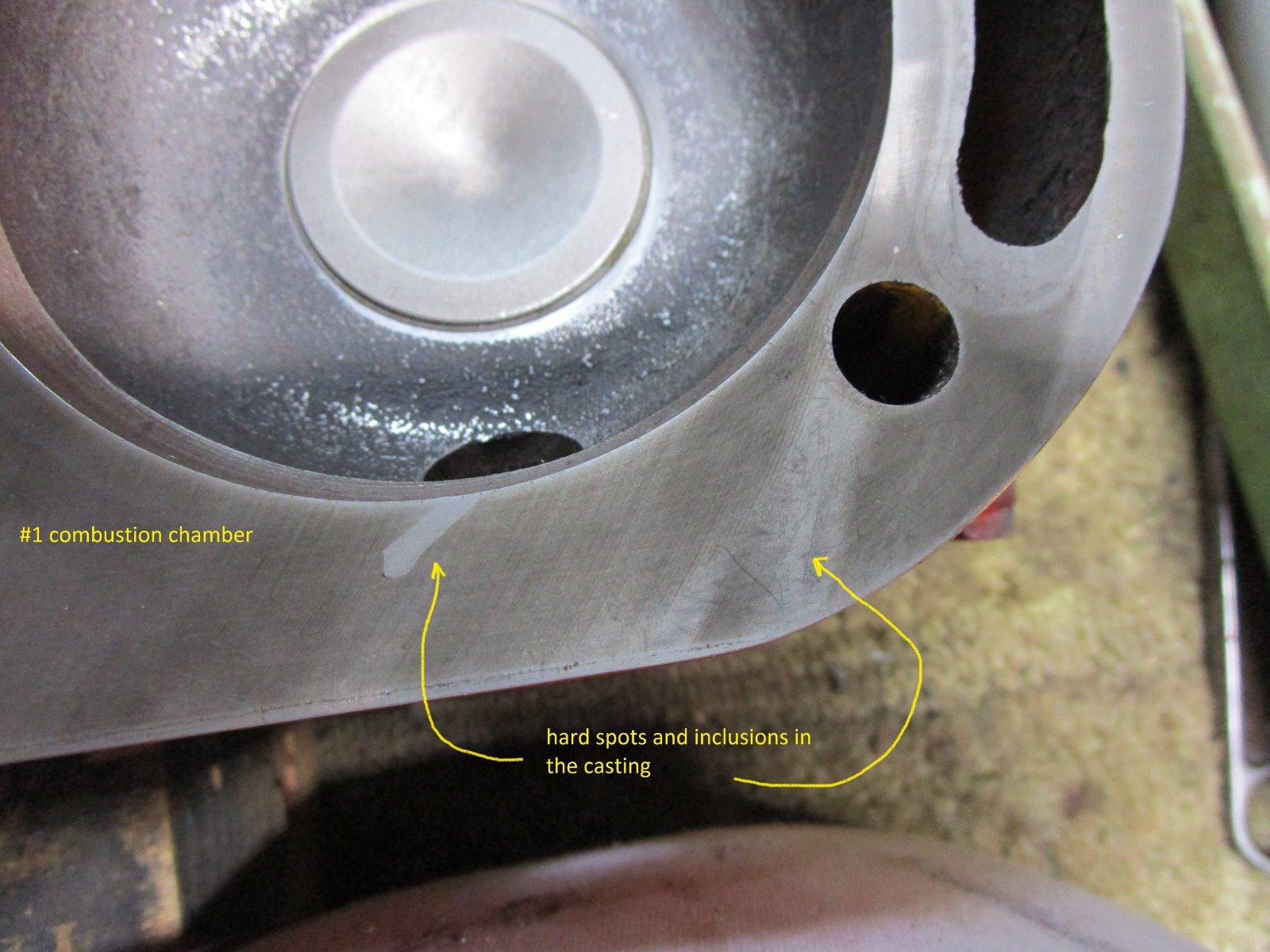

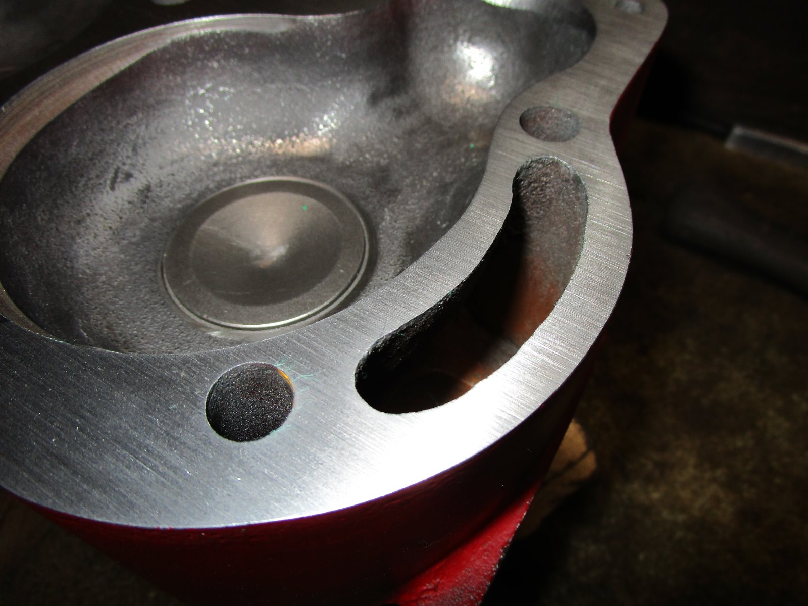

Are you seeing cutter marks after milling in these "hard" spots? Maybe the "hard" spots are low. I would have the head machined using a surface grinder to alleviate the "hard" spots.

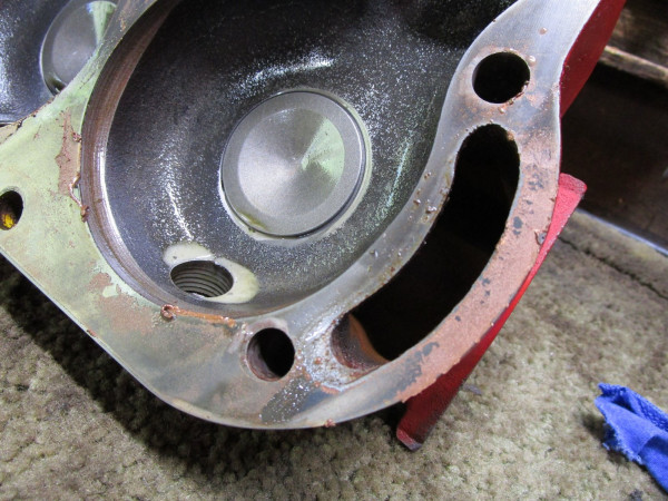

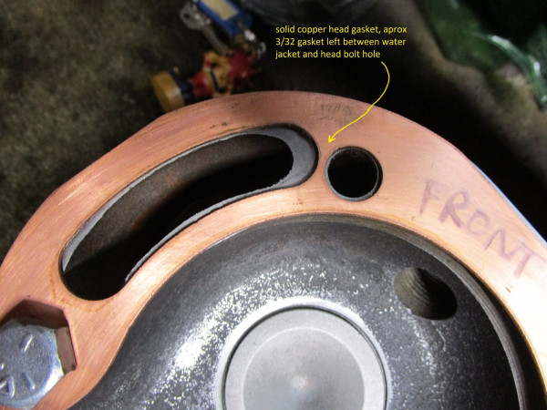

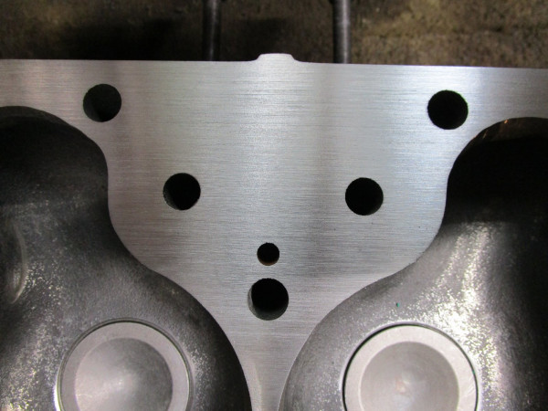

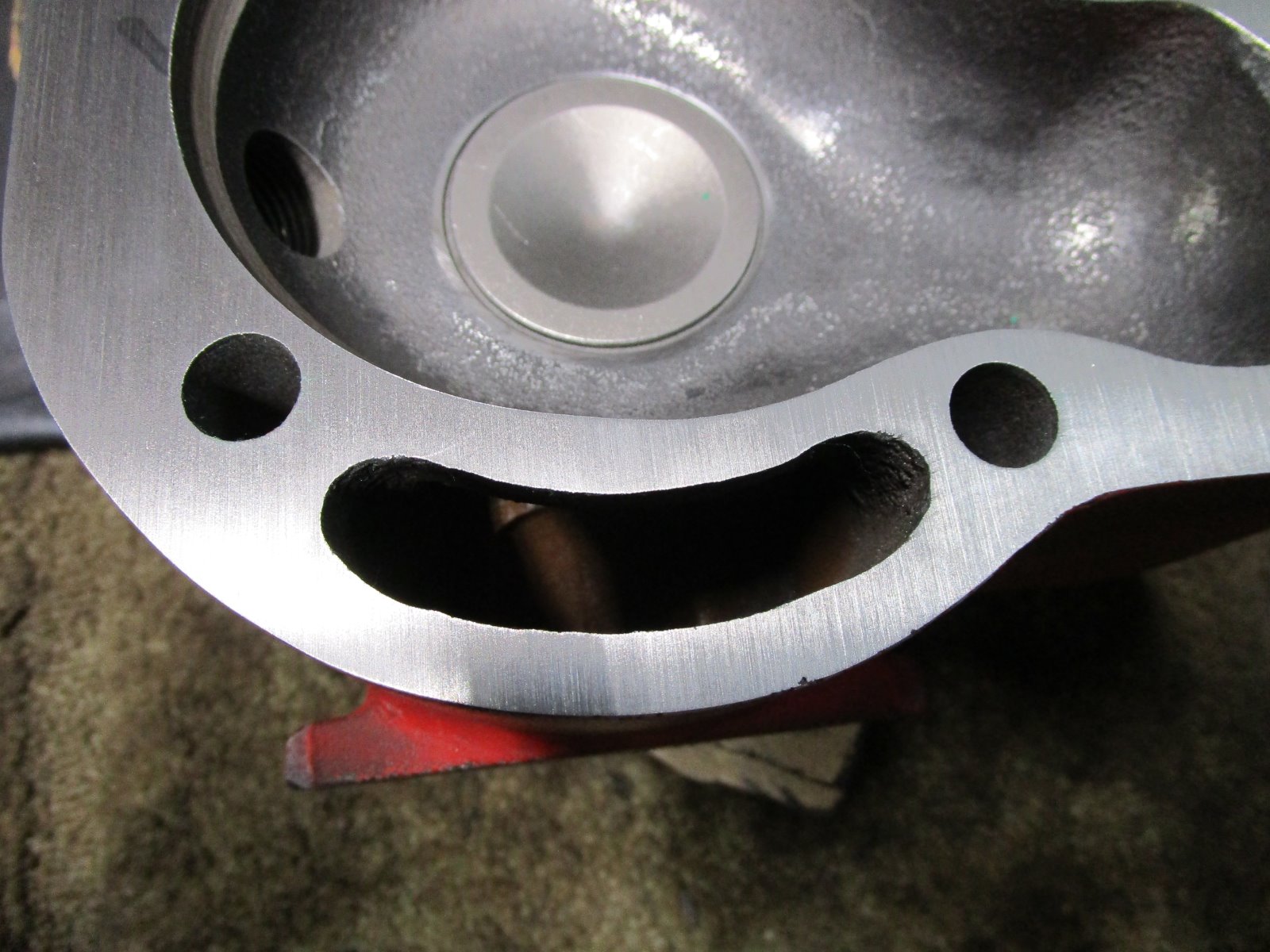

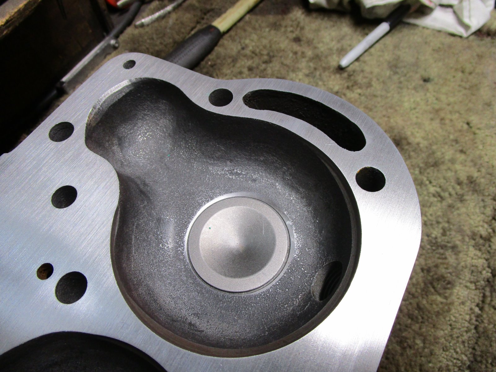

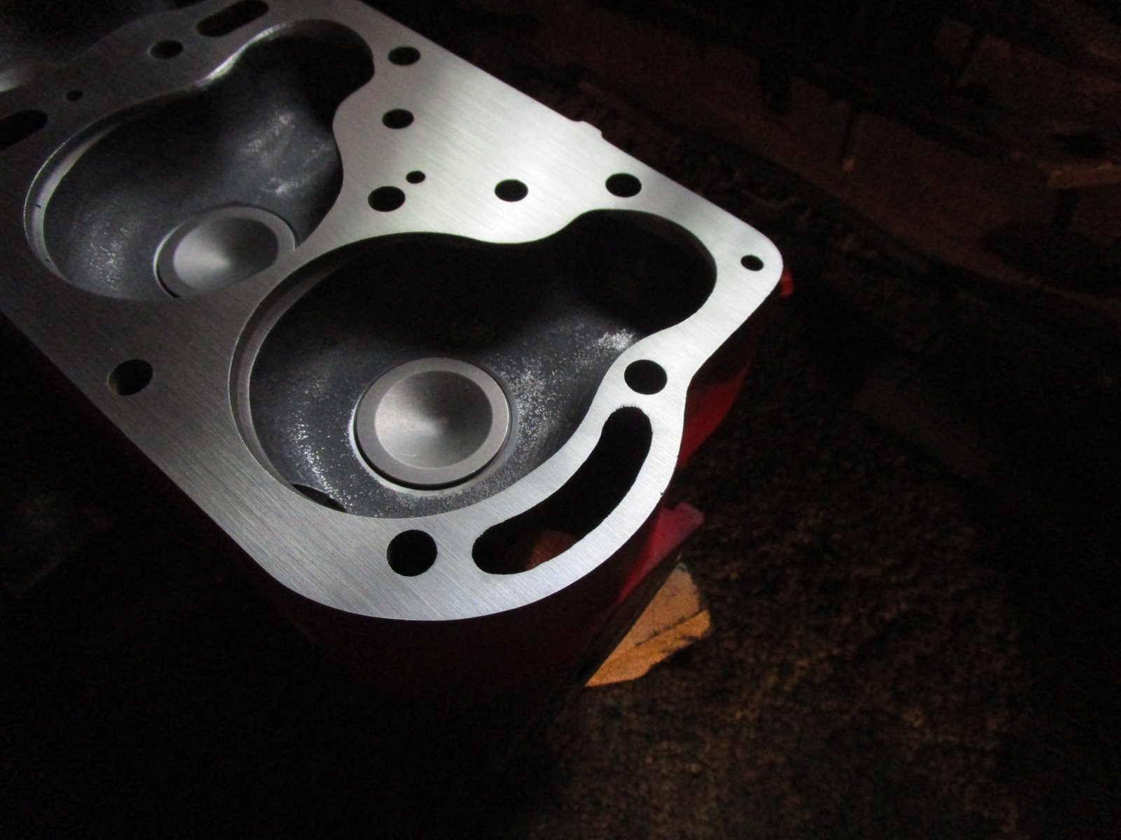

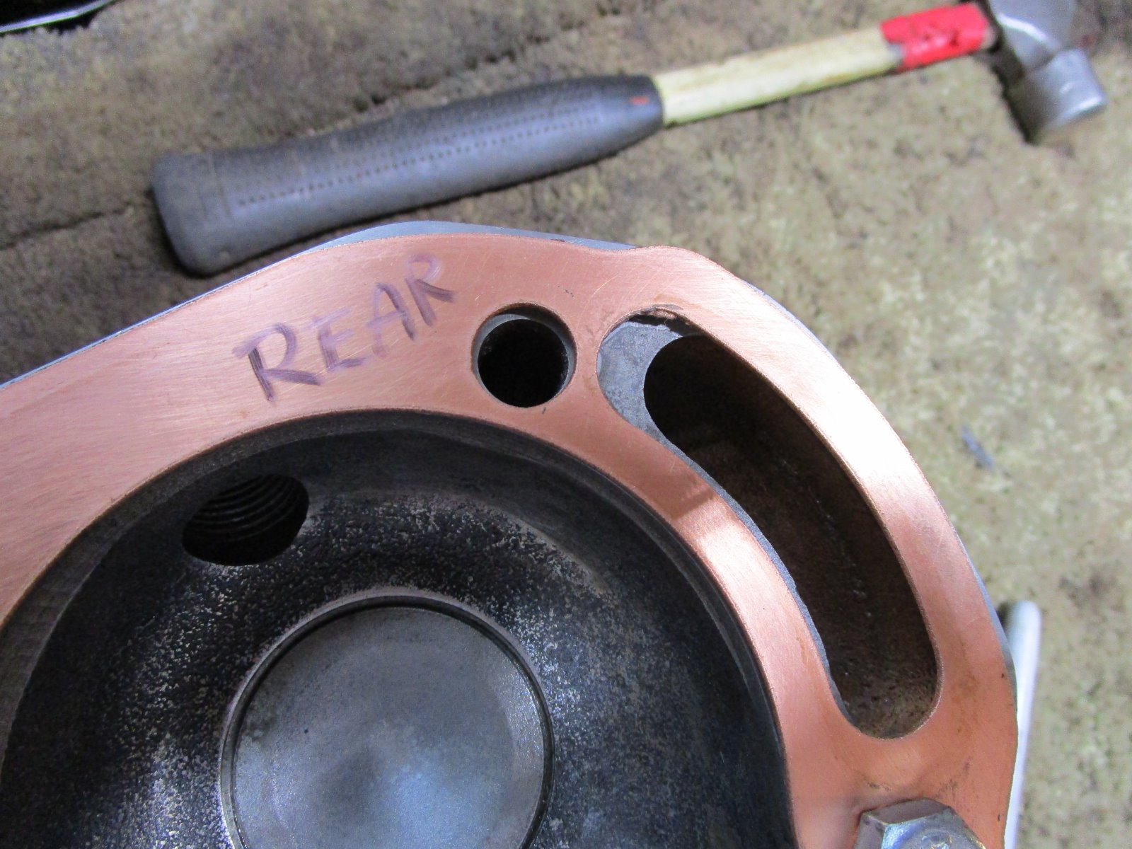

Here are a few more pics. They show some of the obvious hard spots. They may not even be a problem. But its all I can really see or find using straight edges. The only thing I can not really test is some pits or old scratches in the cylinder wall. My mag will not reach into the cylinder far enough with both prongs. They are below the water jacket in the solid part of the casting that would should leak to the outside if they were flaws. I removed the piston so I could get a good look at all the cylinder wall just in case there was a crack. They really look like old rust marks or scratches to me.

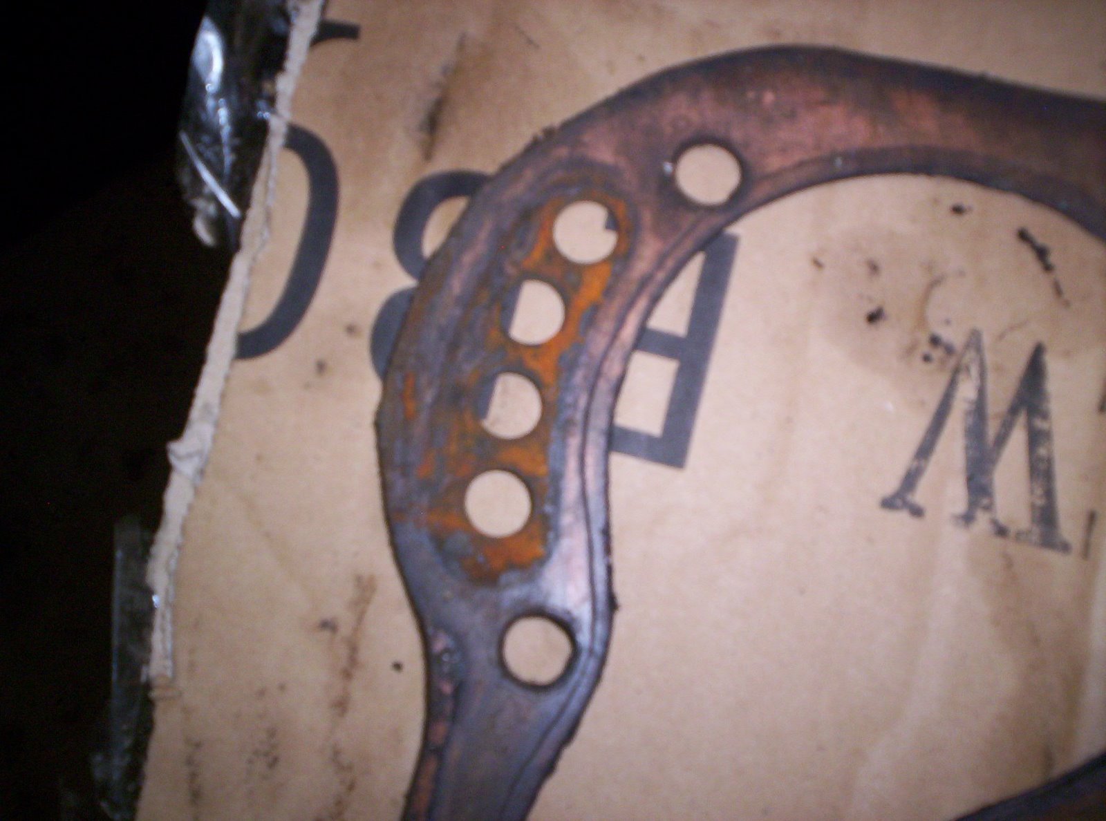

I show some pics of the head and block with the solid copper gasket I just removed in place. The hole for the water jacket is machined too big and only 1/32 inch of gasket is left to seal. I tested the "Fitzgerald" gasket I plan on using this time. It fits a lot better at the water jacket holes. But there is very little gasket at the area between the bolt holes and the cylinder wall. The fire ring is all there is to seal that area.
Im taking the head to a shop tomorrow to re-deck the surface. They use a belt sander type of surface grinder. It is old school, and has been used in the industry for years for normal rebuilds of most OEM products. The only negatives I have found on line are from pro hi performance engine rebuilders. It is probably not a good choice for hi compression engines, but should work OK for making a flat surface on a T head. The shop also has the tools to test for warp, twist, or low spots before we surface it.
Thanks again for the input

Forgive me if I missed it because there is a lot of material here. Is the current surfacing job done on one of those machines with a grinding head that protrudes slightly above a flat table and, by hand, and operator works the head back and forth across the table? Those are very prone to human error. I have also not heard good things about belt sanders The very fussy engine shop that I use said they tried one for awhile and no matter what on the far ends where the belt enters and exits the work the belt relaxes and takes too much off the ends. It was a brand new machine and they had reps come out and finally got fed up with it and sent it back.
I wound up buying from them their Van Norman Rotary Broach and that holds the head stationary while the cutter passes underneath and it makes things dead flat. The same is true of the combination surfacing / boring machines that many shops use now where you mount the head to a table and the cutter passes over it. I'd recommend finding someone with better equipment that will remove the human element from the equation.
The Blanchard is a neat idea but unless they have special tooling I don't know how they'd hold it. The Blanchard has a big magnetic chuck where you slap your plate, part, or fixture down on top and off you go. Unless they have made tooling to hold a head upside-down and contend with the irregularities of an unfinshed casting, I don't know how they would deal with that. The Blanchard was the perfect application for the plate for your pan straightening jig but this is different.

I’ve seen hard seats installed where that had broken thru into the water jacket. On an overhead when sitting, it trickles onto the back side of the valve, only leaking into the cylinder when the valve opens. And when running, on intake stroke, the extra vacuum sucks it right in. We looked all over! Until we let it sit for a bit while we scratched our heads... and water started running out the header! 🤔
Pressure check everything separately... it can’t hide forever

I have never pressure tested a engine before, But I guess I could re-use the old solid copper gasket and bolt the head back on. It is easy to remove the other pistons at this time. So with the head back on and plates made to seal the inlet and outlet of the block and head I could fill the block up with water and use a air chuck and air gauge to monitor the pressure, to slowly pressurize the system. With the pistons out I could at least see where the water is coming into the engine by looking up into the lower inspection door. How much pressure should I use . ???

Donnie, second try at posting this. I had a similar problem with a standard iron T head. It was down to a blunt set of cutter tips on the mill used to surface it. Where it was making short cuts either side of the combustion chamber, the cuts were passable. As it crossed the head between the combustion chambers and had to make a full cut across the head it cut less deep, leaving a ridge between the chambers.
In your case, the very short cut either side of the water outlets at the front and back of the head would be deepest, the cut on the short sdie of the combustion chamber less deep, and the cut between the chambers even less deep. The different colour you see may not be harder inclusions in the casting, but a result of the tool cutting difference.
The next step may be having a custom made gasket to match your head to get optimal width sealing surfaces.

I took the head to the shop today to have it surfaced. With Walters concerns letting me know the questions to ask (thanks Walter) and after talking to the owner of the shop who has been there over 35 years I decided to give the belt sander a try. After checking it with his straight edges he estimated we would remove about .005 thou. He placed it on the belt and ran it for 2 to 3 seconds. Then we flipped it over to see what was "shiney" The spot between the front two bolts was already showing to be flat. Also the entire outer edge showed to be flat. But the center areas of the head still showed no "shiney" It was like the head was milled into a "bowl". So he put it back on the machine and ran it for maybe 10 seconds. When he flipped it back over the entire head was fresh "shiney" except a small area between cylinders #1 and #2. He flipped it back over and ran it about 5 seconds. This time it was "shiney" everywhere. I really like the finish. It has just a little "tooth" to the surface. Its not a mirror like surface but just rough enough to barely feel. I forgot to ask what grit the belt was but it looks like 320 or maybe 400 grit to me as to the finish. We had checked the deck height before he sanded it. After sanding he checked again and it showed .004 thou removed. He judged the amount he would remove by "eye" when he first used his straight edges. He said he could see the "bowl" I mentioned before. His "eye" said it was about .002 to .003 thou of a "bowl" so .005 was his target removal. I was really impressed with his abilities. 35 years at the business showed. He said he has done thousands of heads thru the years, with very few problems. I do not think the belt sander is a good option for Hi Performance/Hi Compression engines but for T's, I'm happy with the results (so far). It was 25.00 to surface the head. I mentioned that I had about 20 to 30 original ford heads that I may want done. If I take him 10 or more he will do them for 15.00 each. I think Im getting ready to sand blast all my good looking heads, mag test them (I have my own Magnaflux test equipment) , and have him surface 10 of them. Then list them on e-bay a couple at a time. If it is clean, and you say it was tested, things sell very good on e-bay, but if its dirty or unknown, not so well. So today was a good day in Arkansas Model T Land :)
Im not sure if the "bowl" had anything to do with my problem or not. But now, I do feel more comfortable that the head is flat. I guess my next step is to try and pressure test the block and head using the old solid copper gasket. Any thoughts on how much pressure. ??
Thanks for all the input.... I can usually "work thru" all the problems I have, but its sure nice to have someone to "cry to" when things keep going to pot...
It was hard to get pictures of the finish to show up,

I have a related but unrelated question about this head. I know a lot of you guys mess with the speed stuff . My question is about the step or ledge where the cylinder counter bore is. Should I take a die grinder and knock the sharp corner off the ledge. It will be easy to do at this time. I am wondering if it may cause carbon build up and pre ignition problems later ????
Its the little ledge shown in this photo. All cylinders have the same ledge.

Good deal. I'm glad to hear that he found an irregularity, both measured and the same seen when resurfacing. Given what he found that makes me think the last machine was one of those where you run the head across the table by hand. It is very easy to create exactly the situation he described. Even if it doesn't fix your current ailment, you can have peace of mind knowing a potential gremlin has been rectified.

My local machine shop had one of those grinding wheel surfacers. They are not the best solution. They graduated to a belt type surfacer. That meant a serious upgrade to their electical supply to stop the neighbours having a brown out whenever they started up the 30 hp motor on the machine. It is mainly restricted now to facing manifolds, especially effective on the bolt together combinations of alloy and cast iron.
All heads/blocks/alloy pans etc. are surfaced on a mill. They made their own cutter head which utilises different cutter buttons for different finishes on different materials. It is super accurate and absolutely controllable.

Push thru grinders like the Van Norman and Petersen are great IF you know how to properly set one up, level the wheel, and use it. If not, you can certainly create a mess of things. I'm not fond of the belt sanders for the same reasons, but in the hands of a good operator and a machine in good shape you can get a good surface out of them. Just sayin.

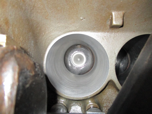

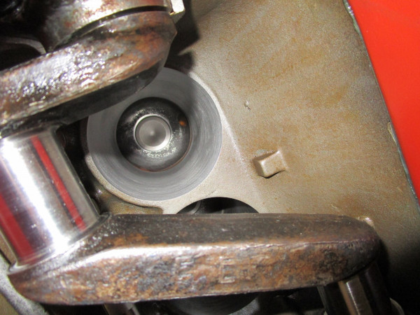

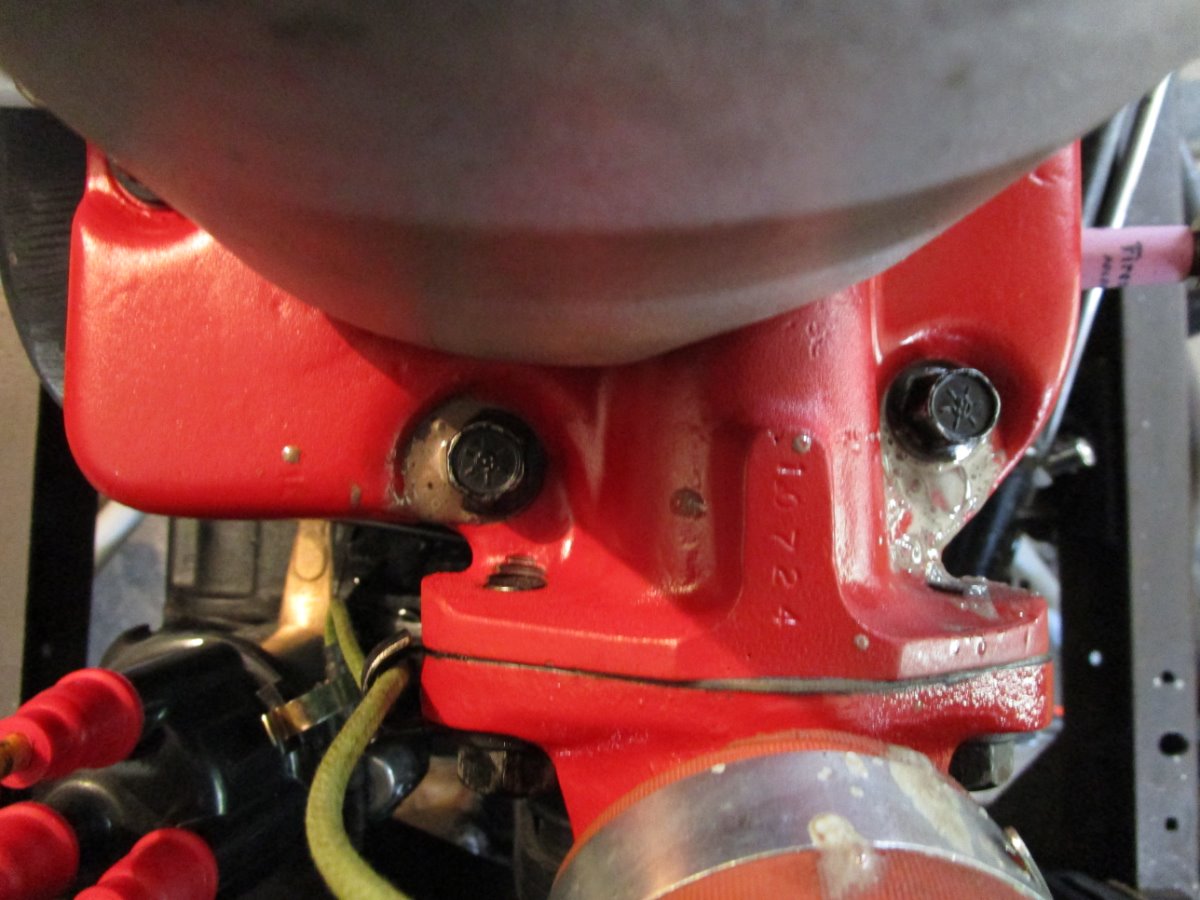

After removing the other three pistons, I put the head back on yesterday, using the old solid copper gasket. I just cleaned it up good with laquer thinner and recoated it with the last of my copper coat. I installed the fresh milled (sanded) head and torqued to 50lbs. I made up a plate for the water outlet with fittings and a gauge to do a pressure test. I was able to slide a gasket between my engine stand mount at the lower water inlet to seal it off there. After filling the head and block with water, I used the air regulator on my air compressor to slowly raise the pressure thru a 100 foot hose to allow better (slower) control of the air. I started at 10 psi and raised it 10psi at a time till I got to 60psi. I reasoned that my combustion chamber/cylinder pressure will be around 50 to 55 psi, so 60psi test should be sufficient. I let it sit with pressure for 2 hours. No sign of any leak at all. :) :). As a Boilermaker we always let our hydro/pressure tests sit for a hour. It sometimes takes up to an hour for a small leak to show up. So just for the #### of it I let it sit 2 hours. I still plan on assembling the engine on the test stand and running it before I put it back in the car. But it appears the hard spots and poor machining may have been my problem. I really hope so.
Here's a few pics showing a very unusual view of the valve in a Rajo 4 valve head.
Does anyone know a way to put those pistons back in without removing the head. :) :)

Piston fitting from the bottom, not unless you remove the crank and also chamfer the bottom of the bore as well.
Another thing I would be checking seeing it's out, would be the alignment of No 1 rod, they bend easy, it could have altered some from hydraulic pressuring while running with water in it. Something that diesels are well known for doing when taking in water.

When you end up with hard spots in cast iron there is a easy solution, but first a regular head broach grinder by design will bounce over hard spots giving you an uneven surface almost undetectable.
I suggest you find someone with a "Blanchard Grinder" This is a commercial precision grinding machine of extremely close tolerances. The mounting table is an electromagnet which hold the head in place while the grinding head slowly traverses across the machine surface. You will have to make adapters to hold the head level and true and make the adapters out of steel not aluminum. I have used Blanchard Grinding for flywheel surfaces parallel plates and any other applications with a great deal of success.
