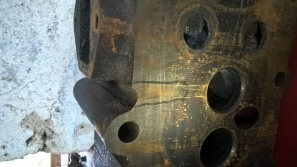

Can't help you on performance but first thing to check with those single port Chev heads is the top of the exhaust port for cracks, they can be bad and not worth trying to repair.

Not worth using the single port- they are prone to cracking! I have a spare '28 head if you're interested

There is a saying about those single port heads -- there are thems that are cracked, and thems that will be.

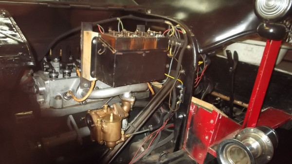

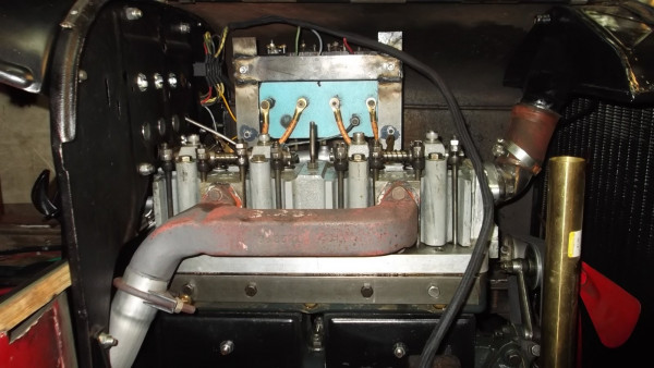

I made my own adapter plate (with a drill press and die grinder), bought the water outlet connection from Gene, had valve guides installed,a couple of seats, new valves and had both side of the plate and head surfaced. Most of my expense was my time figuring things out. I still came in WAY under what the low end over head setup would have been and on top of that learned a lot along the way! :D The only reason it is off the car is because I was having valve sticking issues (found out the pads on the rocker arms were the issue). Before I took it off I was running with coils, made a bracket like the 26/27 boxes. I think there have been a lot of the single port exhaust heads put on, (didn't RAJO or Frontenac have them too?) I too would suggest the two exhaust port head. Oh to add to this, I was not going for power (ok a little more does not hurt :lol: ) but more as I needed to do the whole project and get it done because it was just plain cool and fun.
