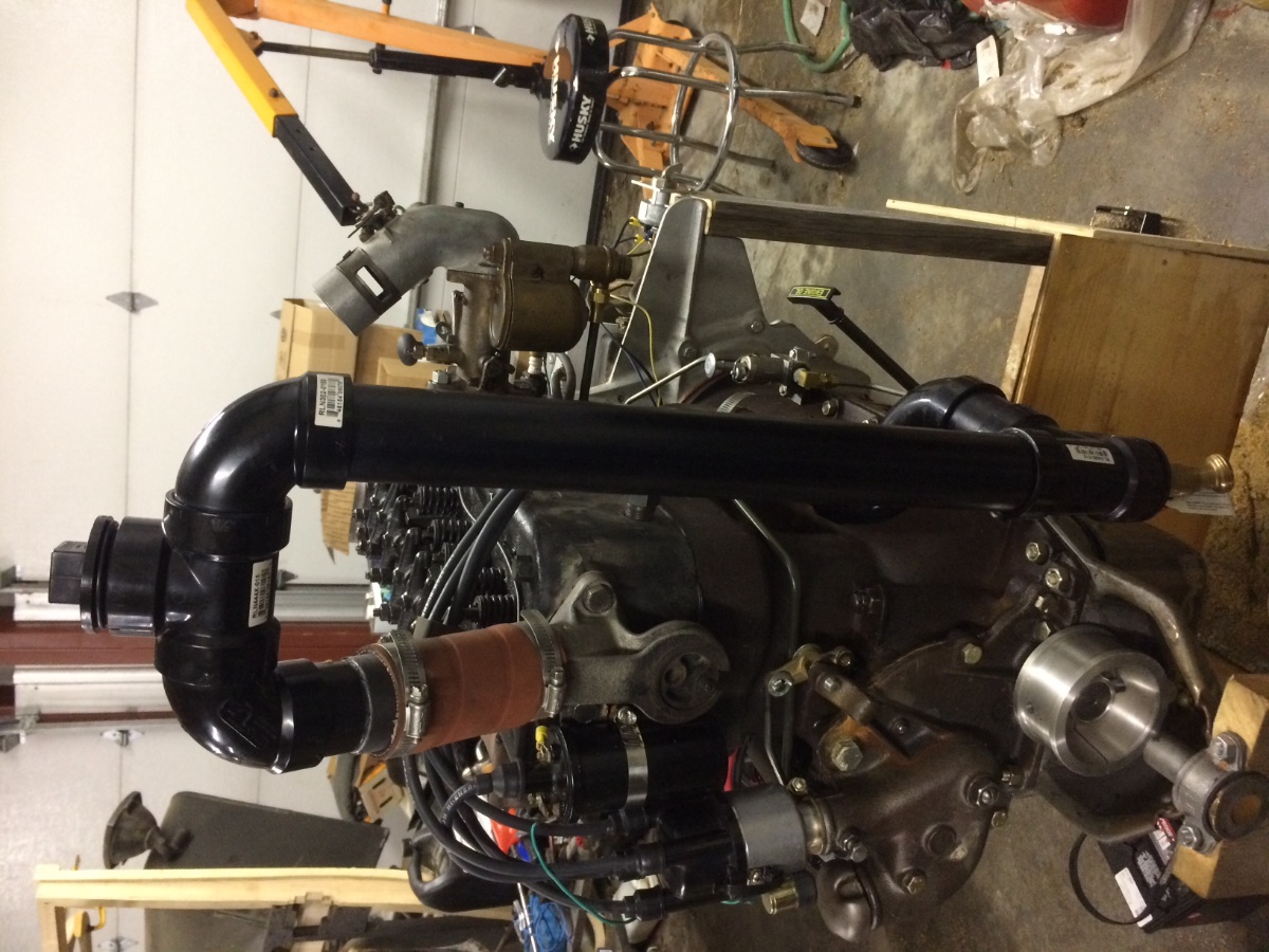

I would seriously consider relocating the coil to the front of the engine, probably to the rh water outlet bolt. I’ll look for a picture of mine.
Re: Routing Distributor wire
Posted: Sat Sep 12, 2020 6:43 pm
by Les Schubert
I hope this helps
I hope this helps

by jsaylor
Made a bracket to mount the coil on the water outlet bolt.
