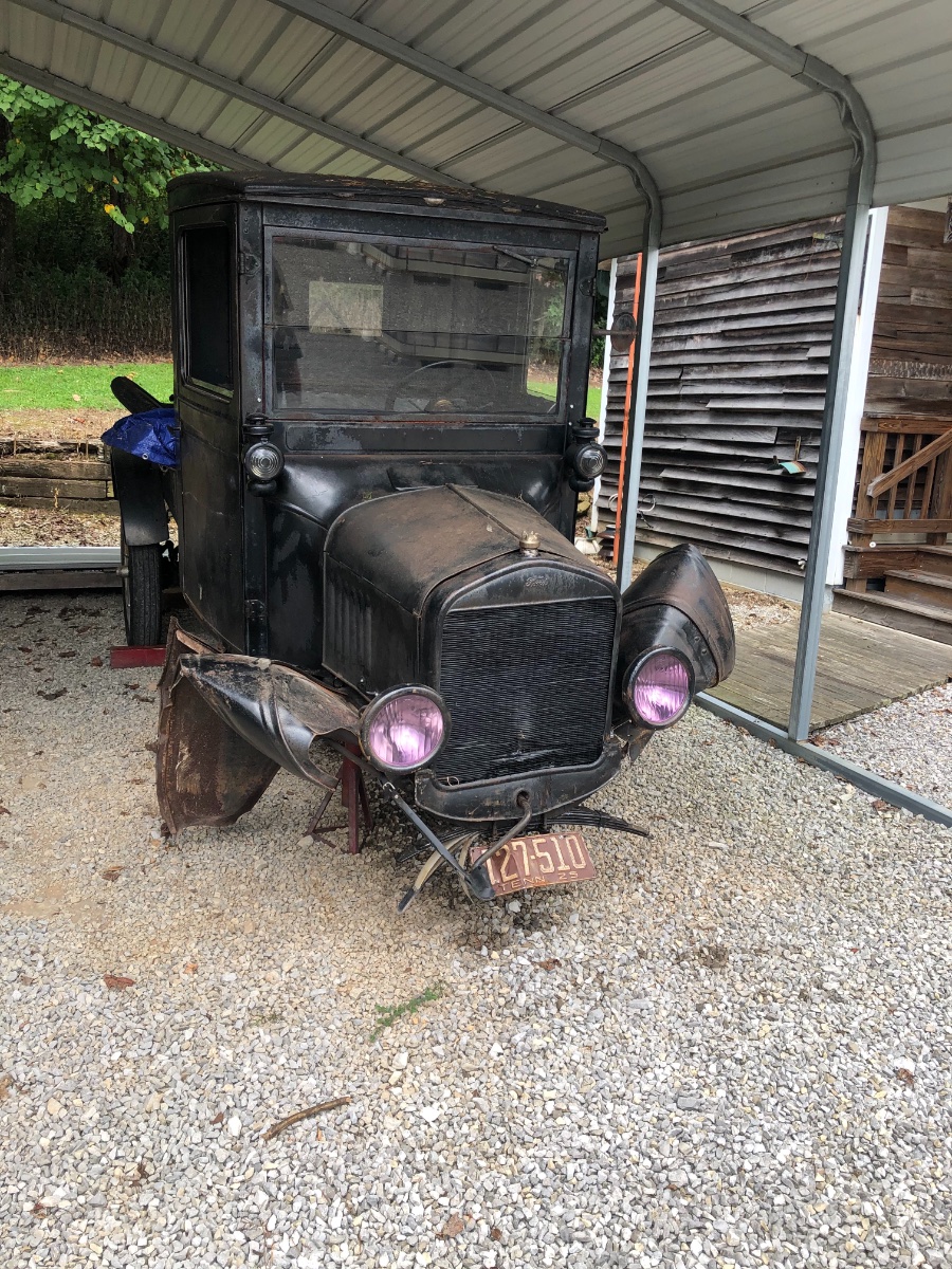

So this does not happen to others. Everyone is just fine, just a little pride dented.
Was showing Rick how well his new TT runs and operates and coming down a hill the accessory Rocky Mountain 6 Speed Transmission jumped out of gear and would not go back in. New emergency brakes with linings would not hold back as they were not seated in fully. A Real Run Away! Rick in the driver seat, me in the passenger, Rick yelling.., "What Should I Do"!.., me.., "Hang on and let me steer"! Aimed dead on to a pine tree thicket. Looks bad but really is not. Was able to steer it right into the trees and knock out the energy with a couple of three inch trees. Already have all the parts in the works so it will be back up and going in no time.
PLEASE FOLKS, NEVER UNDER ESTIMATE ANY T WITH AN ACCESSORY TRANSMISSION AND A NEUTRAL! ACCESSORY BRAKES ARE A MUST!!!!!!
I AM POSTING THIS AS A REMINDER AND MY MISJUDGMENT! No one was hurt.., Thank God!
Only the fenders, running boards and mounts, a little hole in the radiator, drag link and wish bone damaged. Not bad for a 35 mph impact.

wow....hate to see a T banged up like that, but glad yall are ok.
One way to look at it is....if these cars were all sitting in musuems and never getting used, they'd never be in wrecks. And that would be more tragic than one occassionally having a crack-up
If the passengers come out unharmed and the T is repairable, then all is well.
And...it looks like that radiator apron is dinged up. You don't want that banged up thing on that nice T. Better send it to me! ;) ;)

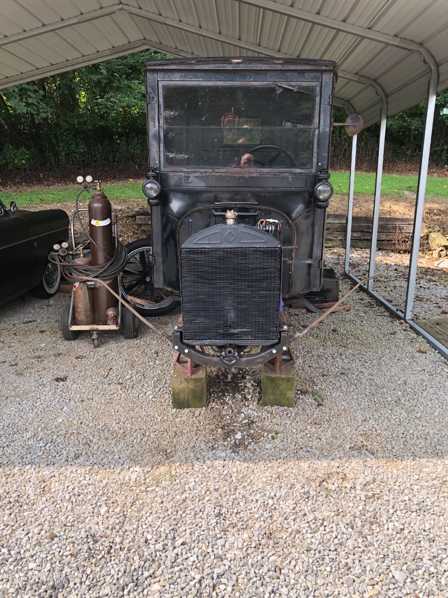

Most can't believe metal being twisted so bad can be brought back like new and even stronger by an air hammer. Here is a days work with two bad teeth (crowns going bad), OUCH!

WOW,that poor truck!
Glad you are all ok.
BUT help me understand,how did it yank the wishbone out of the oil pan and not damage the ball socket?Or is the oil pan 1 of the parts that will be replaced?

Posted: Tue Sep 15, 2020 6:19 pm
by Henry K. Lee
I always use an APCO radius ball cap! Beautiful breakaway system and keeps perfect tension as needed. Also use them on the center link.
No damage at all to the oil pan, the front broken leaf spring did the skidding. No damage either to the front cross member.
The key to straightening bent/twisted metal is to reverse the damage as it happened. That book will explain it.

by Henry K. Lee
And six days later..., Ready to go home.., again!
Locked the AUX transmission in low. I think Earl Shribes, Maaco, and Peach Auto Painting would be proud of that 95 year old paint match!
