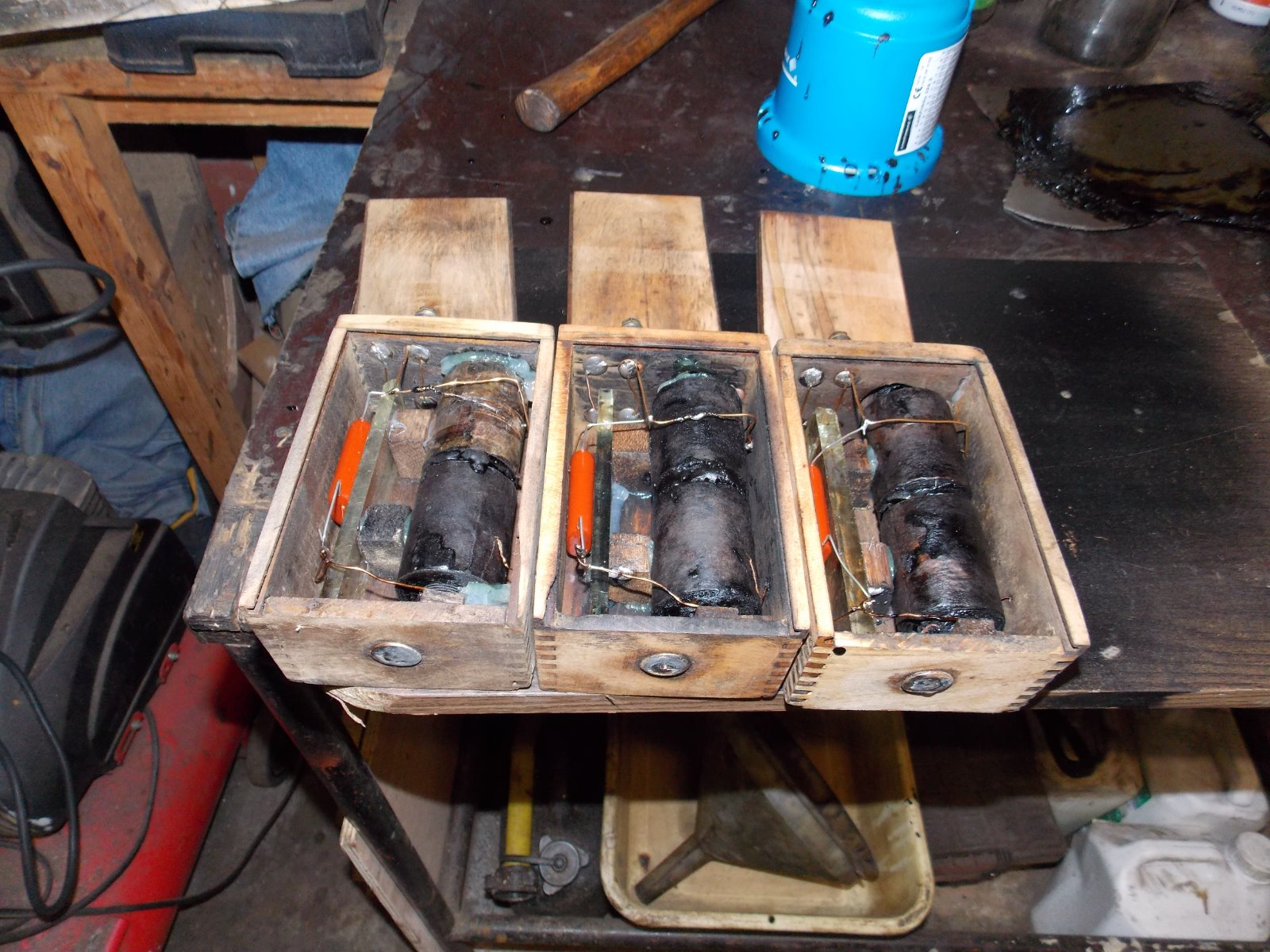

Some time ago I was in a hurry and didn't use gloves when I was filling three coils with tar.
This is what happened.
Be careful and take care use good gloves to protect your skin.
Andre
