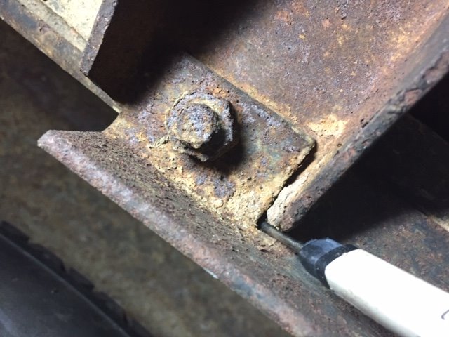

So two with the same brackets .
They do not require any lift of the body - look very closely
at the front of the L angle bracket where it comes in contact with the frame crossover - the bracket is notched at that point so it sits on the underside of the frame crossover - the screwdriver blade is in the notch - you take the nut off the frame /wood block bolt and assemble at the front and work backwards with rear bolts dropping in from the top

Thanks! That answers a lot of questions!
Apparently it IS a stock ford bumper bracket. It's just that few people have ever seen them before.
