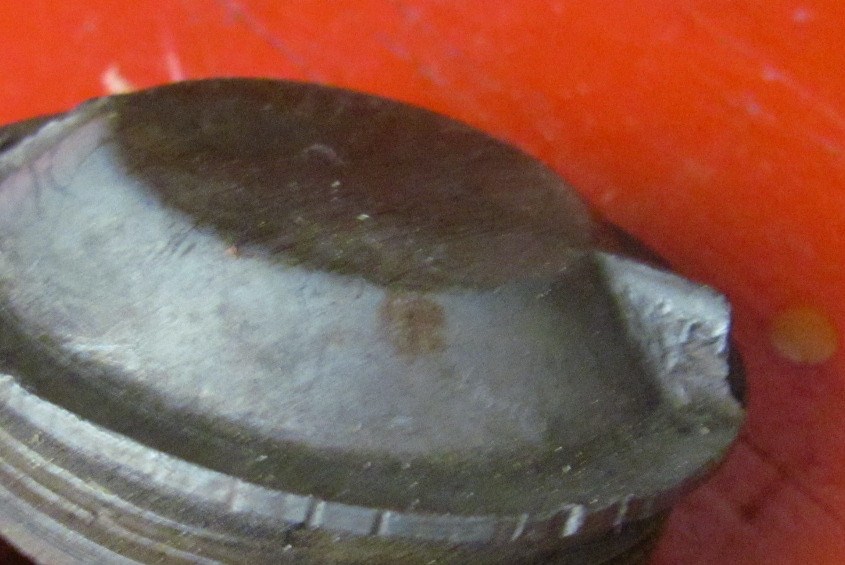

The late gas cap has the metal cover or baffle underside to prevent gas seepage up the vent holes.
Here is original late cap:
Lang's offers a real nice reproduction of the later cap.
Like to always put a dab of Vasoline on the threads of the cap from time to time, keeps them from sticking with modern fuel that has dyer additives and other stuff during formulation for environment or seasonal and various states requirements
