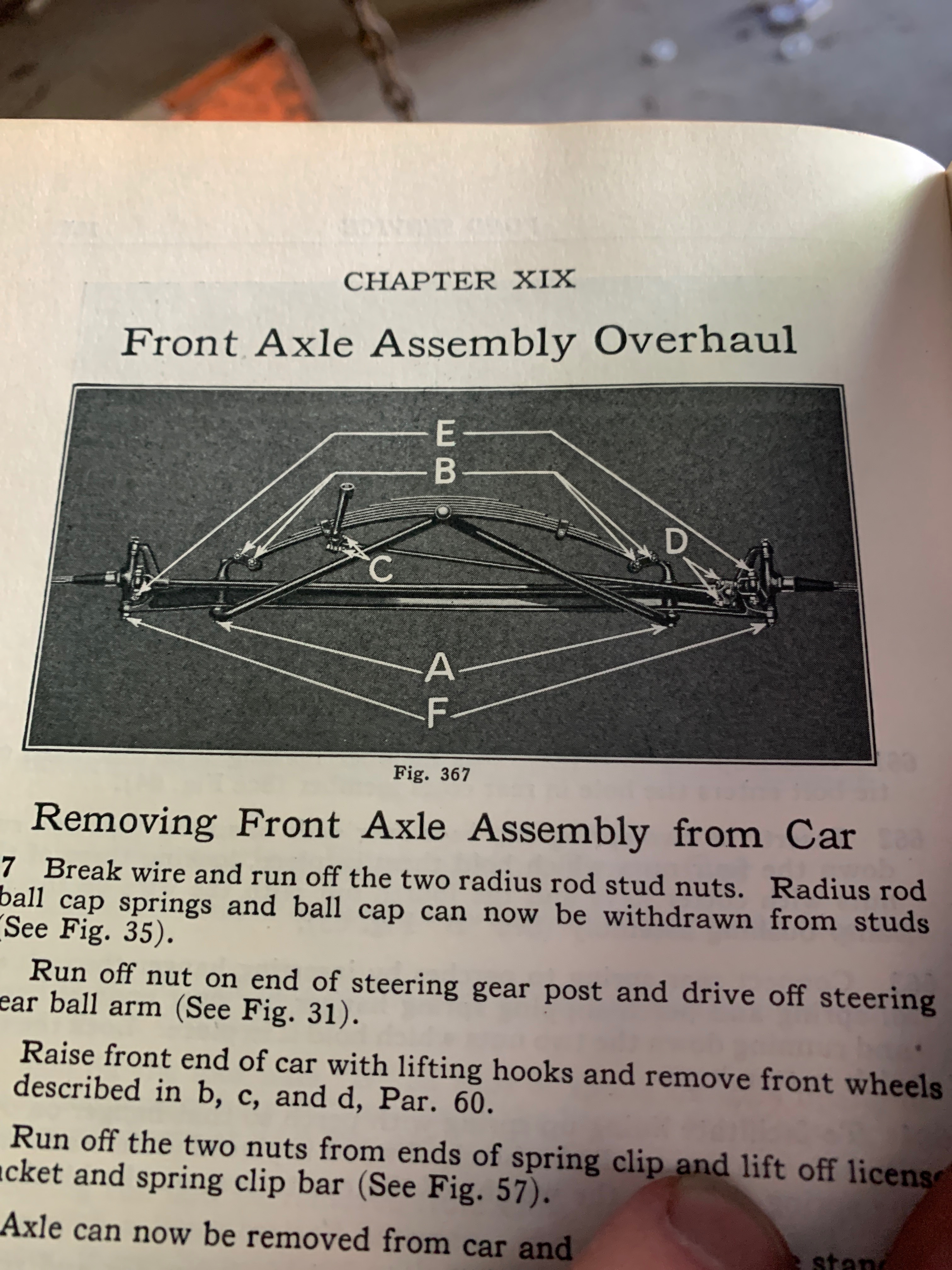

by Dan Hatch
Also look at page 166 Ford service manual.
