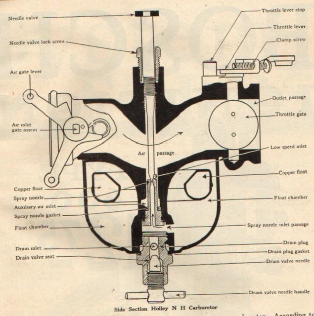

If your carb has not been rebuilt, it should be to ensure it does not leak. Rebuild kits can be purchased from Lang’s or Snyder’s. All carbs are different, so start with 1 counterclockwise turn of the choke from the closed position (7/8 to 1 1/8 turns). You may need to set the float level. On my Holley NH the float level is set 15/64” from the flange to the top of the float. Turn the key to BATT retard the spark and advance the gas. Engage the emergency brake which also puts the transmission in neutral. Be sure to chock the wheels, if you are not sure if the emergency brake is set properly, so it will not run over you and take off through the back wall of the garage. When starting with the crank, position the crank at 7:00 and using just your four fingers (do not wrap your thumb around the crank), engage the crank ratchet in the front pin of the crankshaft, Pull the brass choke ring and hold it while yanking the crank up clockwise to 12:00 and let go and quickly get your hand out of the way (Some people prime the carb by keeping the key off while holding the choke ring and cranking several times, then turn the key to BATT and then cranking without holding the ring out). When cranking with the crank, you let go at 12:00 and quickly get your hand out of the way, in case there is a backfire, that will cause the crank to spin counterclockwise and break anything that is in the way. If the car starts, quickly go to the cab and advance the spark, give it some gas by pulling down on the throttle lever and switch the key to MAG. Now you are ready to cautiously learn to drive it. Good luck. Jim Patrick

Fuel: Starter fluid is a shortcut. Give it a huff, then try to start it. If it kicks off, you've found the issue.
