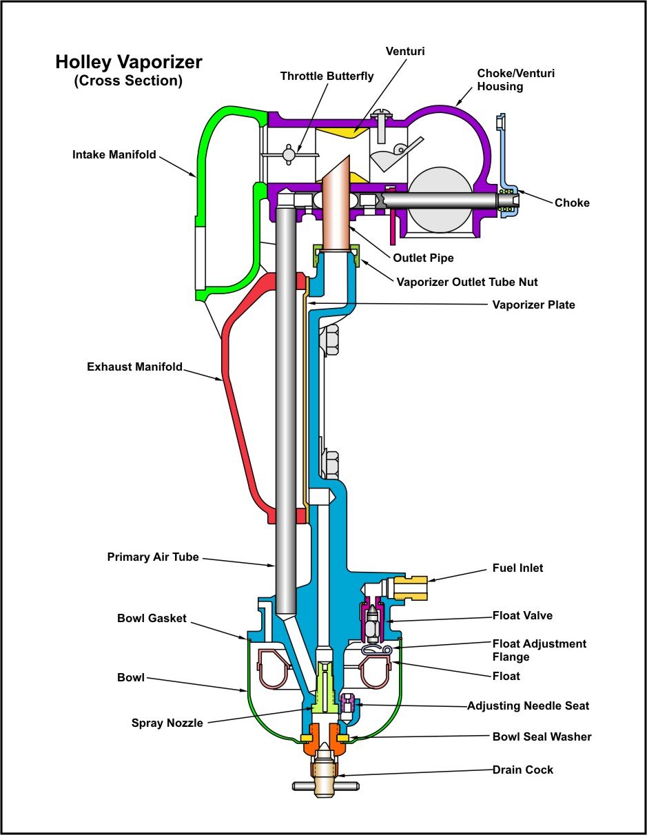

I have disassemble the vaporizer unit and am having difficultly removing some internal parts as follows:
1) The Primary Air Tube ( where it passes thru the top and bottom of the Exhaust Manifold)
2) Primary Air Tube (where it enters the Choke/Venturi Housing - - this is a short 1" piece because the pipe rusted thru at the top of the exhaust manifold)
3) Spray Nozzle (in the bottom of the carb)
4) Fuel Inlet Piece ( However, I assume it is probably OK not replace it!)
I have sprayed these parts with "Yield" penetrating oil many times. This oil has worked every well on numerus other parts and fasteners. I haven't yet tried heat. I am waiting to get comments on heat and any other thoughts.

Re: Help with Vaporizer Carb Disassembly
Posted: Mon Oct 19, 2020 1:29 pm
by perry kete

by BLB27
I don't see a piece listed as "fuel needle".
Posted: Mon Oct 19, 2020 3:38 pm
by perry kete
I believe it's part number 6279 That threads into Number 6278 in the upper drawing .

Posted: Mon Oct 19, 2020 7:59 pm
by TFowler
Sorry .....had a brain fart
I meant to say spray nozzle (part #6286) NOT fuel needle
