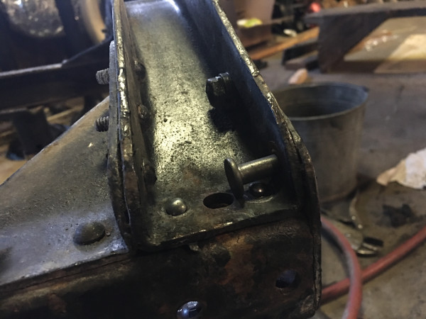

Looking at my previous post in the link above, I noticed something I didn't mention.
I attached the bracket to the cross member out of the car and installed them together. The bracket and the old cross member had been bolted in, so it was easy to unbolt them and do that part of the job on the bench.

Be careful as to the order of installing the rivets on the front cross member☹️
Installing rivets on front crossmember
