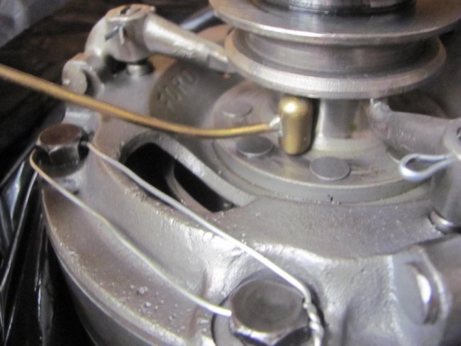

Maybe want to rethink that advice Jerry
Photo courtesy of: Dan Treace
Re: Clutch adjustment - slipping
Posted: Wed Oct 21, 2020 6:51 pm
by Jerry VanOoteghem
Scott_Conger wrote:
Wed Oct 21, 2020 6:49 pm
Damn it! I realized I was wrong and rushed back to delete my post, hoping nobody would catch me. Too late.... :( :oops:
Yup, do what Scott shows to do...
