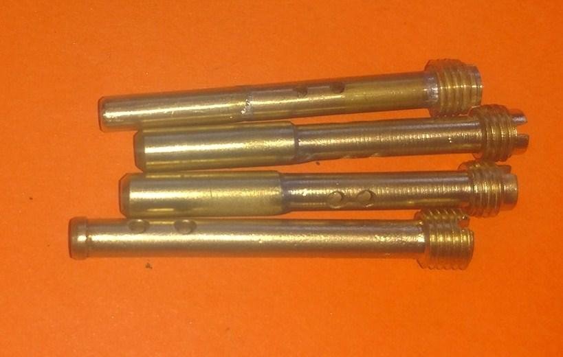

I made about 20 new idle jets last week, they are almost always damaged or missing.
I fell bad for the guy that sent it to me but I can't warranty somebody else's work or lack of it. There is more to this than wiping them off with an oily rag and painting the throttle control black, which I think is all they did to this one.
This is going to be an expensive OF by the time he gets it back.
