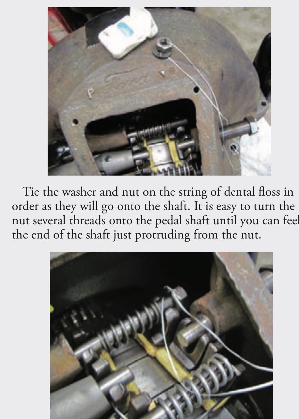

No problems if you are careful on assembly of springs and washers and nuts. Rags below and dental floss threaded on the washer and nut to prevent loss, the floss allows the nut to thread on and then easy to break away.
Large nylon wire ties, hold the band ears, and for me, the clutch fork is held by one too. Keeps the fork from wiggling, and you can direct it in place holding outboard on the clutch lever, one hand there, the other hand just inside the inspection port to lower the cast iron hogs head. IMO, Permatex #2 always works to seal, don’t like messy and sticky fast set RTV, time is necessary for the multiple steps needed to lower, align, fit band fasteners when doing this by yourself, even with practice it isn’t a fast install. Sticky, stringy RTV dries too fast for me. Plus those peeling off shards of dried RTV can find their way into the engine.
Note. In the step below, the pedals were added after hogshead drop.....but prior to any pan to hogshead fasteners. The nylon ties are still in place to keep the band ears together, for getting the springs in place as you wiggle the pedal shafts in. Then add the band washers and nuts, but don’t tighten yet.
Finally cut and pull out the nylon ties, then push the hogshead down tight, and then begin the process of placing all the bolts to fasten up. Hint: Put the inspection cover on temporary NOW. That open hole can swallow a pan bolt nut or lock washer, don’t ask how I know :roll:
