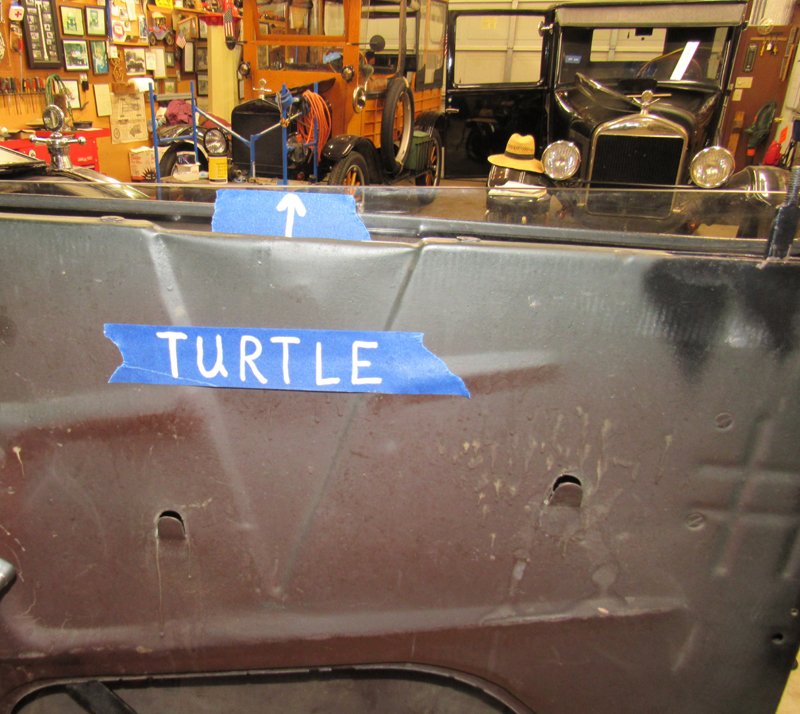

The windows on my ’27 Tudor won’t roll completely down. It’s very uncomfortable if I want to hang my elbow on the sill while driving on a hot summer day. My arm rests on the glass and not the sill because the glass won’t roll down far enough. It lacks about an inch. I’ve had this car for about a year and yesterday I attempted to find the problem.
Luckily, I have a another ’27 Tudor that I can use for comparison. Starting with the passenger door.

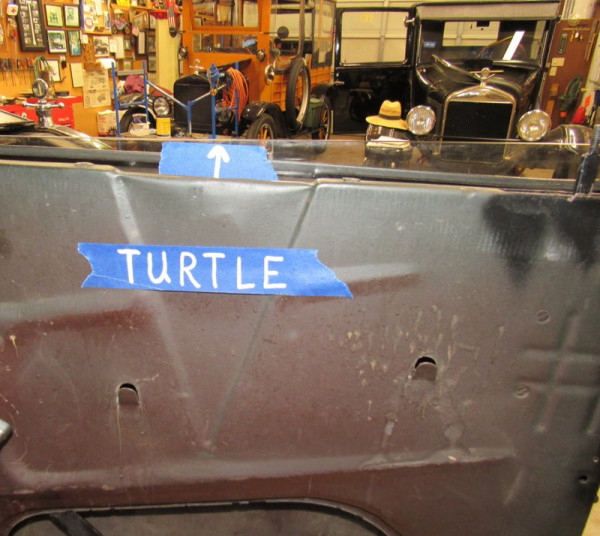

This is Turtle- the one that wants to show it’s glass.
[image]
When totally rolled down, one end of the glass still protrudes about an inch.

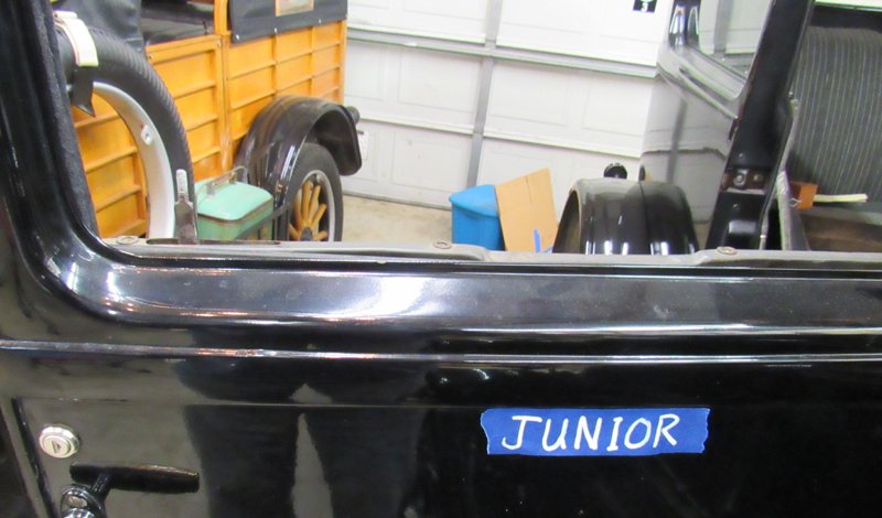

This is Junior- the one that hides it’s window.
[image]
[/image]
Both windows roll up and seal very well. See the comparison.
[image]
Both windows rolled up tight. Good seal.
[/image]

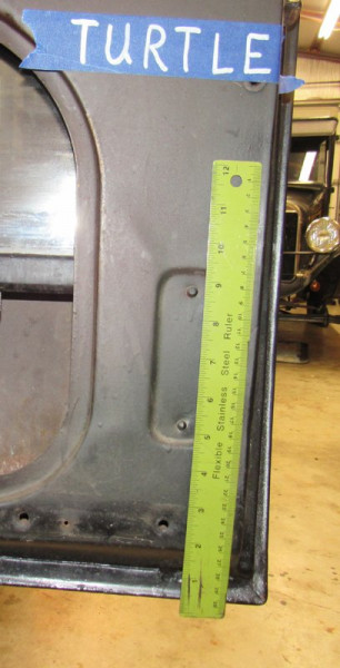

This is what I've found....
1. The window assemblies with the Bottom Metal Glass Channels attached- measure the same- side to side---top to bottom.
2. Even though both cars are 1927 models the Lower Glass Stop Bumpers vary in the distance from the bottom of the door. Junior's factory installed bumpers are 1" lower than Turtle's. This allows Junior's windows to reach a lower stopping point which is below the sill.
My question....Do I lower Turtle's 2 Lower Glass Stop Bumpers? Or, should I cut the excess off of the glass at the top?

I would not cut off any of the glass. If you do, you may find that you will have a 1” gap at the top when the glass is rolled all the way up. Instead, get a piece of 1 1/2” x 1 1/2” Open celled foam, the length of the glass. Take a razor blade and cut a 1” deep slit in the center, down the length of the foam and keep it in the car. Whenever you go for a drive, slip the slit of the foam over the protruding glass and push it down until it seats on top of the door sill. This way, you will have a nice soft armrest for your arm. Jim Patrick
PS. If you make the foam deeper than 1 1/2”, say, 2 1/2”, it will allow you to compress the lower 1” of the foam and stick it into the window gap on each side of the glass to hold the foam in place so it will not blow away if you remove your arm.

The two bumpers that support the glass channel when the window is all the way down is what I would look at first. My 26 coupe windows have the top edge of the glass exposed when all the way down too, as it did with the original glass, channel, and regulator parts, but not an inch as yours does. I agree an inch is too high, and something is wrong.

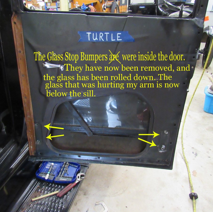

I just finished removing the 2 window stop bumpers from the passenger door. Soon, I will temporarily clamp them 1 inch lower than FORD did. If the window comes down so the top of the glass is below the top sill and the window cranks up and down like it is supposed to, then I'm in business.

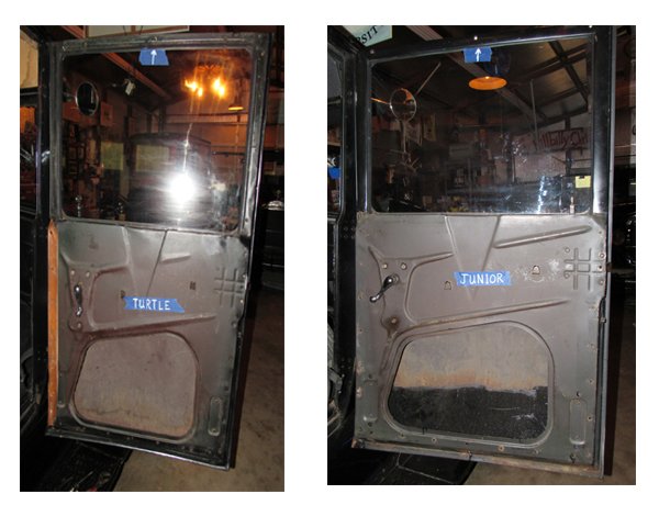

Rick- I'm not familiar with "the glass book", but both of these cars have the same height windows. I don't know their width because they are still in the cars. That doesn't mean that both cars have their original doors. My original post states this but I'll repeat that the indentions in the 2 doors for the STOP BUMPER are not the same. The indention on Turtle's door is approx 1" higher than Junior's door. Which brings up a question- why would FORD install 2 different doors on the same year model car. Could one of these cars have doors that belong on a coupe instead of a Tudor?

Today has been a fun day, trying to figure out why the windows completely roll down on one ’27 Tudor, yet the other Tudor (same year) the window lacks as much as an inch from disappearing. One inch is all it took. Tomorrow, I'll re-attach the Stop Bumpers- one inch lower that they were this morning.

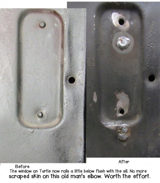

Post by Bill Robinson » Tue Oct 27, 2020 7:26 pm
