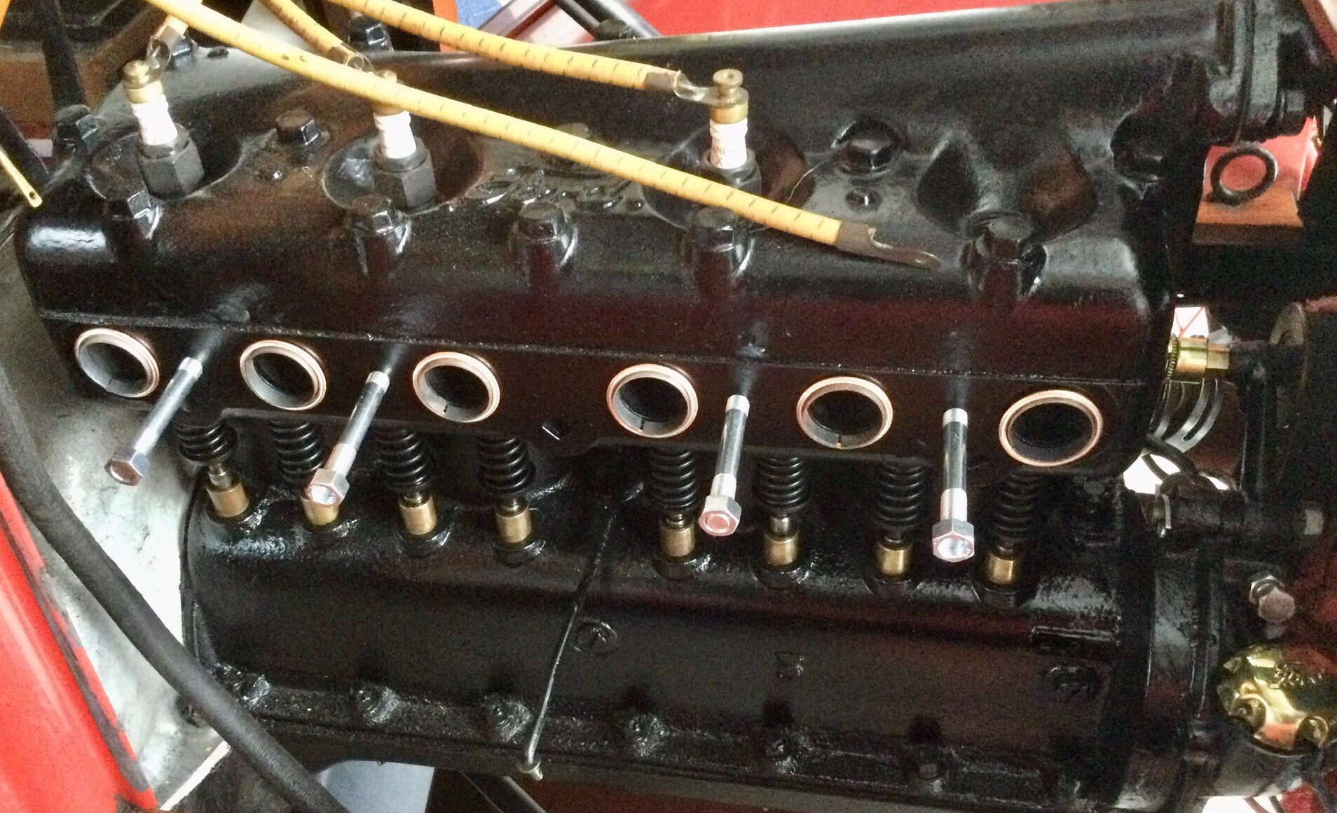

I think it's easier to fit a manifold to rings in the block than vice versa.
Re: Gland rings
Posted: Sat Nov 14, 2020 12:54 pm
by Jerry VanOoteghem
I hang mine from the sleeves that are installed in the block. I also "glue" them in place with a dab of grease, just to keep them from getting displaced by the slightest bump. Yup, the grease makes some smoke on a first start, till it burns off. But, what's the fun if you don't have a little smoke? ;)
Tighten the clamps down very gradually, alternating from one clamp to the next in repeated steps, so as to pull the manifolds down evenly.

Re: Gland rings
Posted: Mon Nov 16, 2020 11:13 pm
by Derrick16
Great info, thanks for the pictures! I will put them in the block first.

I fully agree with the method of installation, and that is the way I have always done it. But, I have always wondered while putting on the rings which side is in and which side is out. The rings have a slight opening with a asbestos type of material inside. The opening is not in the middle but on one side, and after it is compressed the opening disappears, but, which side should it be facing at time of installation, towards the block or towards the manifold, or, does it make any difference? Or, am I just getting too picky on a subject that is irrelevant? Just a nother stupid question. Frank
Re: Gland rings
Posted: Tue Nov 17, 2020 9:02 am
by TWrenn
Hey Frank!
That's just but one of several reasons I like the "all inclusive" copper rings I posted pics of up above. Just stick 'em in the block and go! Very easy, and they seal absolutely perfectly. To me, this is a case of "you get what you pay for". Good quality and good service.

I put the gap on the block side.

Starting with a straight exhaust manifold. I install the nuts and keepers on the studs or if using bolts install them on the bolts and tighten just enough to keep from falling off. Then install the glands into the block. Next, the copper rings with the gap toward the block. Then I place the exhaust manifold in place, and turn the two outside keepers to a position which will keep it in place but allow me to place the intake manifold. Then I rotate the two middle keepers into place and tighten enough to hold both manifolds from falling off but not completely tight. Next rotate the two outside keepers to the proper position and with all keepers straight across I start tightening a bit from the center to the ends and go back to the center to the ends. I use a 10 inch wrench and do not turn as far as I could but enough to seat everything. After the engine is warmed up, I tighten again to about 30 ft lbs or with experience tight enough to seat everything but not so tight as to twist anything off. I do this same way as I do head bolts. After driving the car I check tightness each time I drive until it stays at the desired torque. Then leave it alone until next time I need to remove it.
