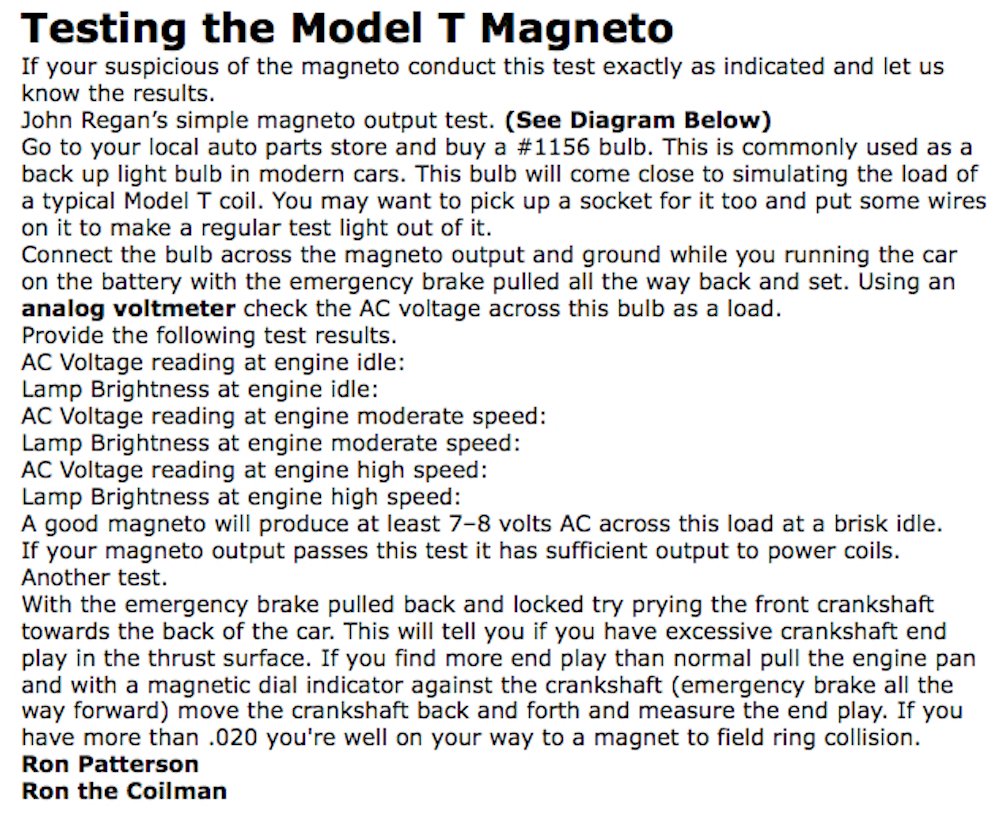

Yes, as long as you can run on BAT you can test the magneto.
As the car is already running on twelve volts I assume it has 12 volt bulbs and has the generator properly adjusted. If you're installing the stock ignition switch the stock wiring should work.

Easy test - start the car on bat, get out the trusty Volt-Ohm meter, set it to AC volts (at an idle you're only putting out a few volts), put one lead on the mag post, the other on the hogshead or other unpainted source of ground. Mag present = voltage shown on the meter, Mag absent = no movement on the meter.
