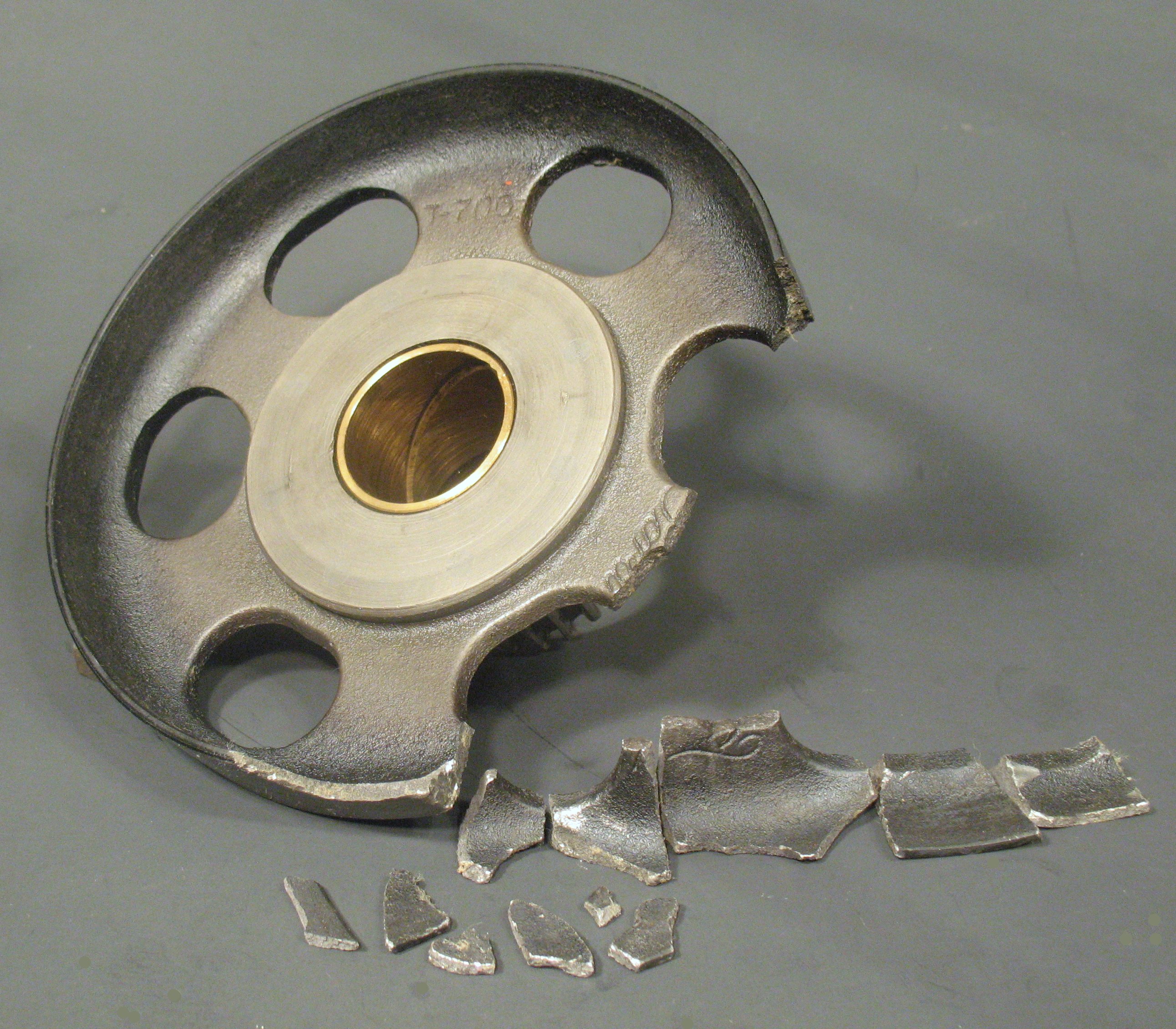

Rebuilding a transmission requires special tools and reamers that for a one time job are going to be a prohibitively high overhead cost.
If you're lucky your local T club may have the tools to borrow, and somebody in the club may have them and be willing to help.
I found a chipped gear tooth and all the band lining was tore up.
Band lining torn up indicates a cracked or broken drum, so you will probably need to replace at least one of those. An original drum may be OK for a car that isn't driven much, but if you intend to use the car a lot it's probably a good investment to get one of Dave Nolting's new drums. Many original hundred-year-old drums have cracks, sometimes unseen, that can only get worse until the drum goes to pieces. VOE

One of Dave's drums will cost a lot more than an original, but it won't do this to you.

From your description the engine may be OK and the transmission probably is not. At this point I would leave the engine alone and pull the hogshead to see what it's hiding. That should tell you whether you need to remove the pan and replace any transmission parts. I would also have an experienced Model T person evaluate the engine and transmission to see what's needed.

ok, I got the hogs head off last night, finally. it took me an hour and a half but i did it!
the drums are loose and have a good amount of play in them, about enough to stick a butter knife in-between. the triple gears look fine with only slight play in all but one, which rocks side to side with about a fourth inch movement. i believe the tooth came from a drum, its a little less than an inch long. could this be possible? the flywheel is torn up in some places as well. it looks like the cotton brake band got obliterated and is in clumps inside the engine and transmission. drums are not discolored and are still smooth, except the brake drum, which has grooves in it. i didn't see any cracks. there is still a slight amount of oil in the pan.

That gear tooth is a problem. Time to pull the engine out.

Clearly someone has been in there - aluminum pistons, oil dippers, etc. Take notice of the fiber cam gear - unless you can verify it's "an era" macerated one, you might consider replacing that with an original steel or aluminum gear to prevent a catastrophic failure resulting in "found on road dead" it won't take long for the generator to remove some teeth !
The bands appear to be late production Scandinavia "tar babies" - not the best on the market IMO. Can't distinguish what the metal chunk is - did you verify it was a triple gear tooth or ???

The first photo of "the chunk" appears to have a gear tooth mark - interesting !
That by itself demands pulling the engine, taking off the pan, and removing the transmission. I expect the wobbly triple gear is seized and has wrecked the flywheel. I don't recognize the "tooth", but I suspect it may be a piece of drum and was part of chewing up that band lining. The engine may be perfectly OK except for needing all the band debris cleaned out of it, but you will at least need to pull the oil tube for a thorough cleaning. Diagnosing an engine's condition from photos is beyond me. I would want an experienced Model T specialist to inspect it.
If that is indeed a fiber timing gear, in my book there's no might consider about it. Don't gamble that it may be OK. Get rid of it. Replace it with original steel, new aluminum, or new bronze. I believe bronze is best.

If the metal piece is a gear tooth, it's not from the triple gears. The rule shows it to be almost 3/4" wide, wider than the teeth on even the earlier tree piece gears and the driven gear. The transmission needs to be stripped to investigate.

Pretty sure it's a tooth from one of the drum gears, (sun gears).

I stoppedby Carsons, this is where the transmission failed. Low drum gear.

This is Carson's transmission drums. The gear on the low drum is galded and broken and the bushing is scored and loose. I'm thinking not enough clearance when installed.
