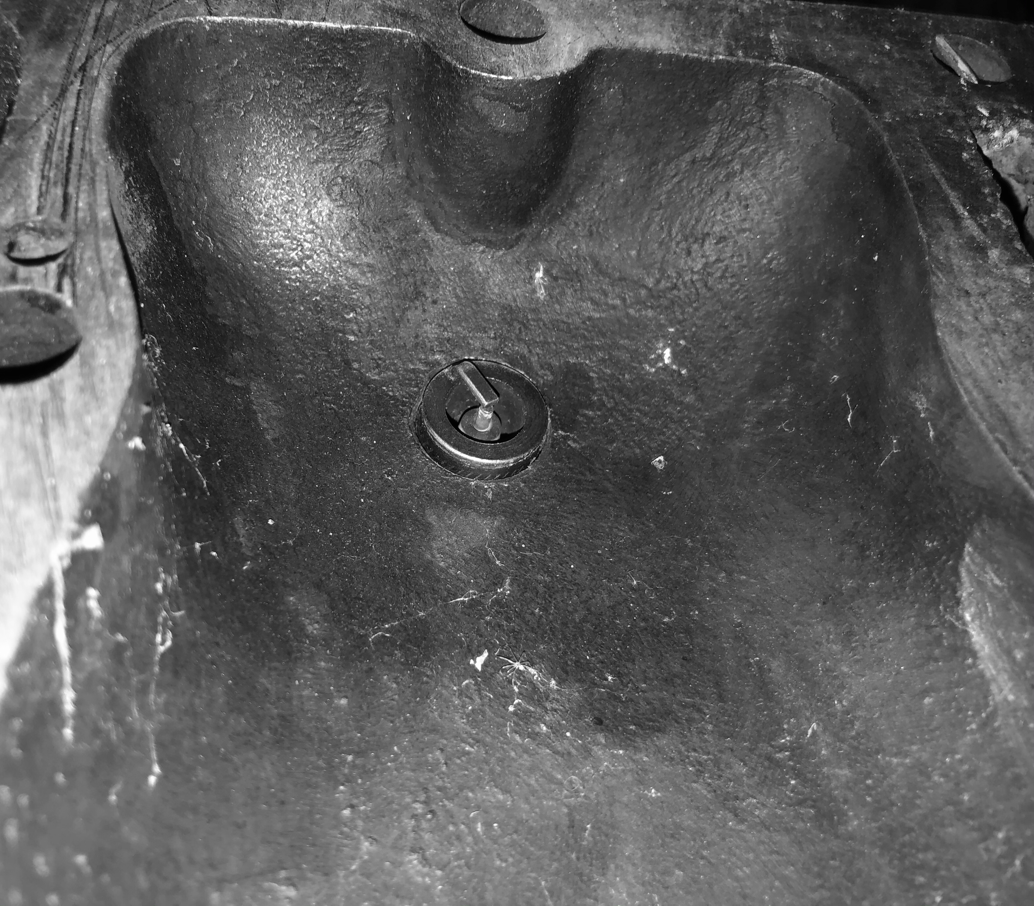

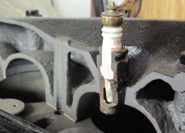

The plug will seat into the combustion chamber of the head, but will sit up as not all of the pipe threads on the plug are used, so the plug will stand up a ways above the pipe thread hole. This is a high head and Ford script Champion X. Other plugs may have different reach or heat range.. This view of cutaway the plug is just placed for reference, it won't actually sit this low.
Don't tap the pipe threads too deep if you are going to rethread those in the head.

Better views of plug reach, plug is Champion 25.
