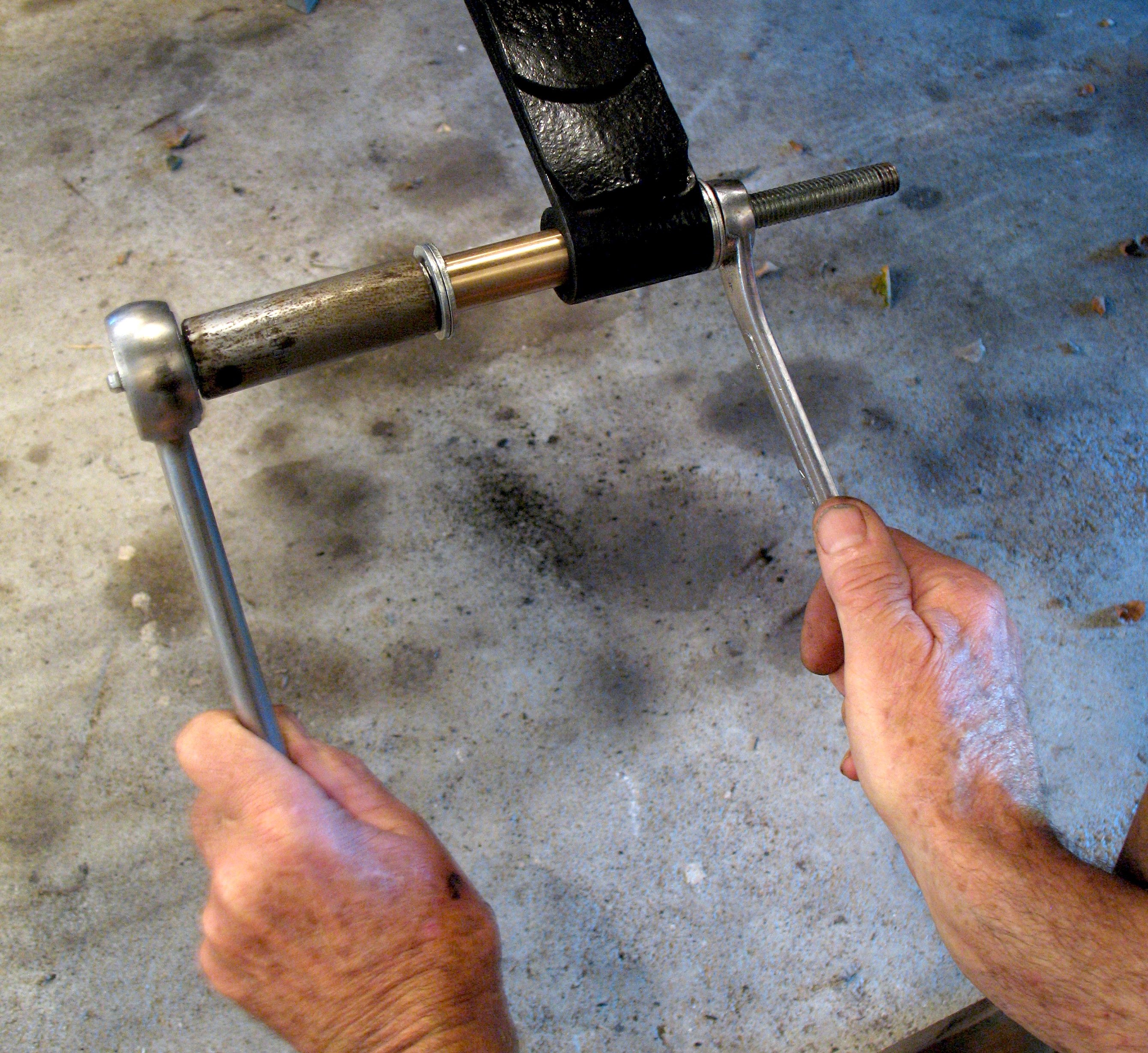

On the theory that it's better to wear out bushings than shackles, I use bronze bushings instead of steel. I buy them by size online.
I use them like this on my 1915, but if you want to use them on your late model car you will need to drill oil holes for the oilers. Lots of folks use chain saw oil because it's thicker than motor oil and lasts longer.
Ream bushings to 9/16" for the shackles (hangers) to fit.
