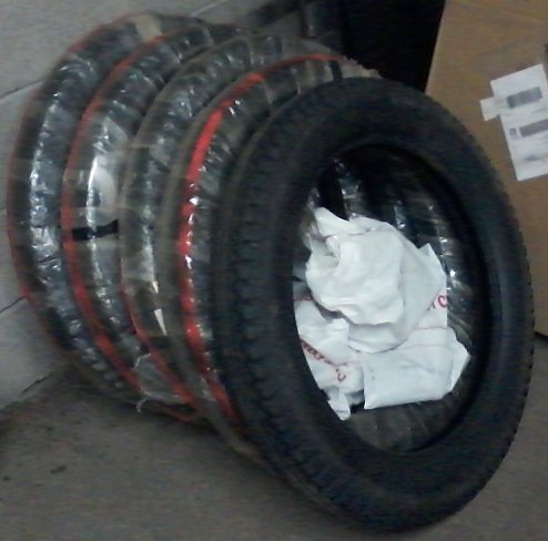

DickC,
About four years ago I purchased some "440/450-21 LUCAS Olympic Tread Blackwall" tires, including a spare. They came straight from Lucas Classic Tires, wrapped in plastic and labeled, "Made in Vietnam". None of they hold any air because that is the job of the inner tube :D . I also purchased five inner tubes from Lucas at the time. To the best of my recollection, they are rubber. Our T does not drive so I cannot speak to handling.
Lucas tires
Lucas tires

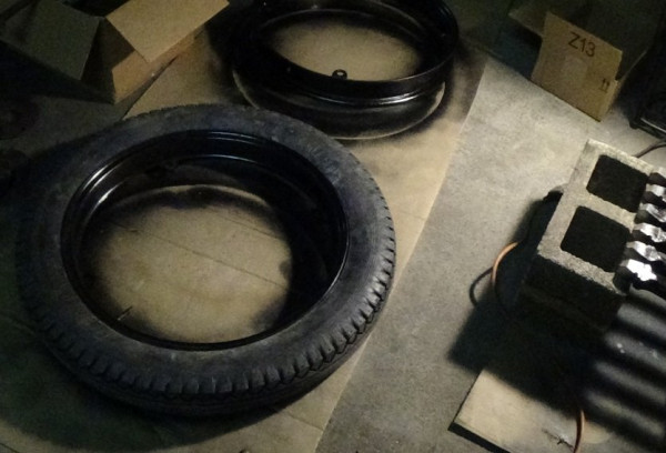

tire mounted
tire mounted
Sorry for the poor lighting from the garage.
