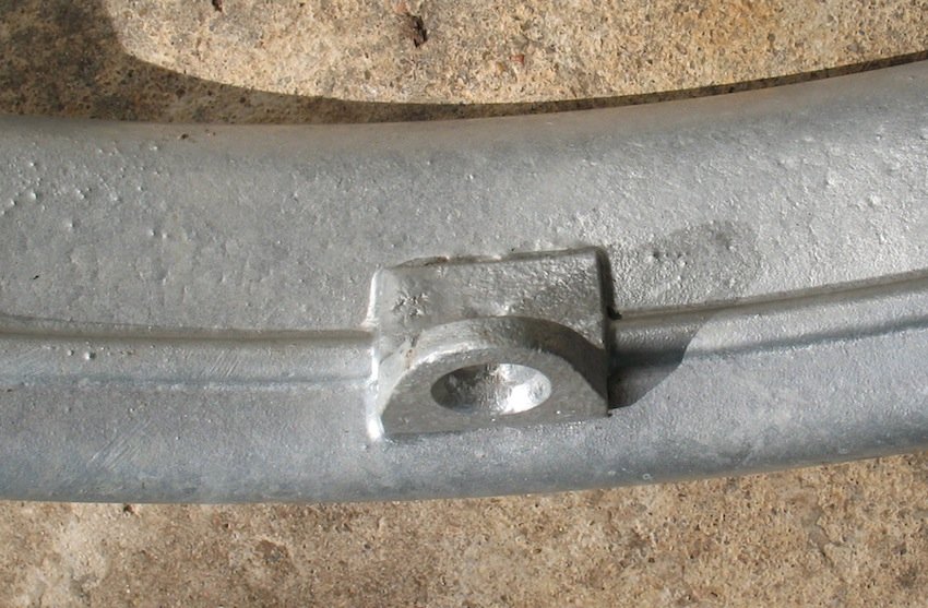

The rim with Oklahoma chrome in 20210102_192543516_iOS.jpg is Hayes. The felloe in the picture above it probably is too, but it has been butchered too much to be sure. Looking for a replacement I would start with Model T Haven, Ron Paetz, and the Neunhoffers. Yes, you can replace just the felloe. But if the spokes are not great you might as well do them at the same time.
The notch on a Hayes felloe should look like this.
The Hayes name is often visible on the lugs.
Hayes rims have the lug that extends past the bead, thus the notch in the felloe.

Wheel 1 and Rim 1 are Hayes. The rim may have the Hayes name on the outside of the lug. I don't know about the others.

Perhaps I'm mistaken about this being a Hayes felloe. Maybe it's Ford. Either way, the Hayes rims fit it perfectly, and it's what I use. There's no doubt about what the rims are, as the name is stamped on their lugs.

Sreve, it would make sense for Ford wheel felloes to have that relief so the Hayes rims would fit as well as Ford rims, so maybe they are Ford felloes.
Ted, your wheel 3 has a pressed in relief at the bolt hole like the ones on my Hayes wire wheels. That is what I suspect is a Hayes felloe.
With regard to the Vowell art drawings, the top left one is representative of what I believe is a Hayes set-up. Top right is like Kelsey, but our Canadian sourced cars did not come with that style of lug/nut. Ours are typical of the right second down having the U shaped lug. You will note that on both these, the felloe has a dumped down ledge on which the longer, inner leg of the lug rests. This ledge is absent in the rest of the drawings, but the U shaped lug is still pictured. I believe this is not correct. Those lugs will cant as the rim bolts are tensioned, as there is no land for the inner leg of the lug to engage on the felloe.
Rather than there being a fault in the drawing of the felloes, It may be that the felloes are correct and the lugs on rims to suit those felloes should be fixed lugs like the Hayes and Ford rims. This is how our 1925 Canadian sourced cars are.

Ted, you raise an interesting point about how the rim actually sits on the felloe. That Firestone rim with the straight up edge relies on the rim binding on the rolled over inner edge of the felloe for support. The rim does not contact the straight up edge at all. This supports my long held belief, formed over many years of T ownership, that the rim/felloe combination relies on the rim binding on just ONE of the two sides of the felloe.
On our Canadian sourced cars, with wheels supplied by Kelsey, demountable wheels up to 1925 had loose lug rims. The matching felloe has rolled edges on both the inside and the outside, and these rolled edges are the same width. Good rims mounted on good felloes, bind on the outer rolled edge, leaving a gap between the felloe and rim on the rolled edge on the inside , that gap being wide enough to accept a credit card.
In 1925 we changed to rims with fixed lugs. The felloes for these no longer have the pressed in slot to engage the loose lug, and the inner rolled edge is WIDER than the outer edge. When good rims are matched to good felloes the rim now binds on the inner edge, and the credit card can be inserted on the outside.
There is another difference in the felloes. Those for the lugged rims are deeper, resulting in slightly shorter spokes.This has caused problems for those who were not aware of the difference when rebuilding wheels.The usual spokes for lugged type wheels are too short when assembled into loose lug felloe.
Others may have differing opinions re the rim binding on both edges of a rolled edge felloe, and it does happen when worn rim/felloe combinations occur.
