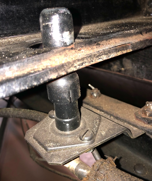

by DanTreace
Frank
Nice photos and details. Might be wise to send your photos to Steve Lang and see if there is some type of issue with a production lot of the higher quality repro switches. The bend of the metal around the footswitch pedestal is interesting.
Have these switches on all of my T's and never issues like you are showing. About the only thing I take care is installing the extension sleeve. Spread the slots in the sleeve gently with a blunt screwdriver tip, so the sleeve glides on without any heavy hammering.
And make sure the switch plate is firm on the frame rail to keep the switch pedestal from being off-center. The load on that footswitch is only with slight heel pressure, as for me, the T's start right up fast with good tuning, don't have to engage the switch but just a few seconds. ;)

DanTreace wrote:
Wed Jan 06, 2021 9:11 pm
Frank
The way you have the switch protruding through the hole in floor board should prevent the failure of the plunger at the base. Only a downward force can be applied. Its the exposed height of the plunger & hole size in the floor allowing for to much forward movement that leverage will cause a failure. Which could also be caused by minimal gap between floor and mounting flange. I'm still concerned with the switch getting wet - same concern with the design of the original switch but not as much - it could drain ;)
