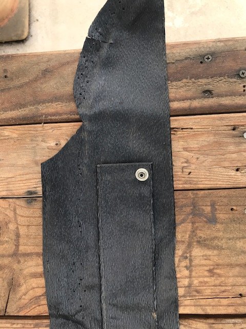

When I restored my 21 Touring back in 1970, it had no top for reference. So I ordered a top from Carter's Cut & Cover. The kit had a flap already sewn on to the wind flap that goes to the under side of the front bow. The new kit from Classtique did not. Since i rarely drive in the rain for long distances and not wanting any delays, I installed without. I did take a picture of the old flap. I have not done any research to find out what was originally provided from the factory.

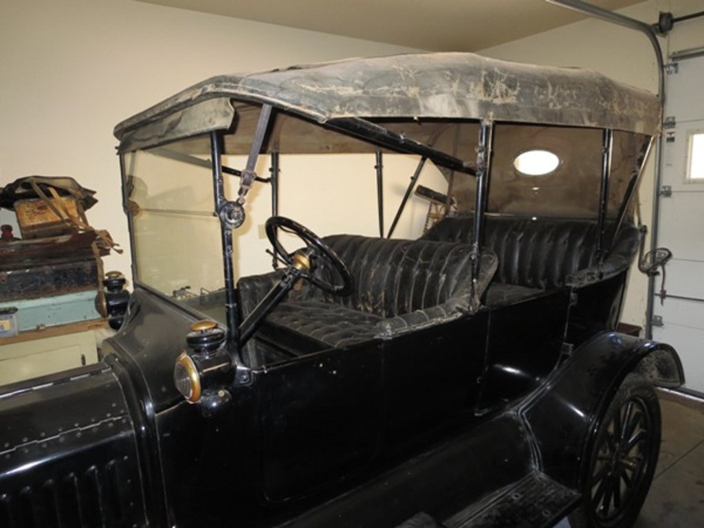

When I had the top installed on my 15 roadster I chose to have the a wind flap installed. In determining how the flap should be installed I found the following two photos helpful. I chose example 1, but example 2 shows an alternative flap.
Example 1:
Example 2:
It would be easy enough to add example 2 to a top that has already been installed.
Wayne Jorgensen, Batavia, IL

Wayne, your example no ! is the way I was describing. It tends to stay in place better when in use, while allowing it to be left above the windscreen if that is what the driver wants. The only extra work involved in adding it to an existing top is the removal and replacement of the binding/finishing strip across the front of the bow.
