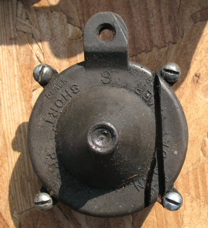

I weld and recut the notch on the timer brush to allow the timer to rotate further counter clockwise. You then have plenty of travel before reaching the belt. I find this problem more common on the Anderson timers.
Andy
Andy
For that reason I don't like Anderson timer. I used new day timer as well
As John says, you're not the first. :D
