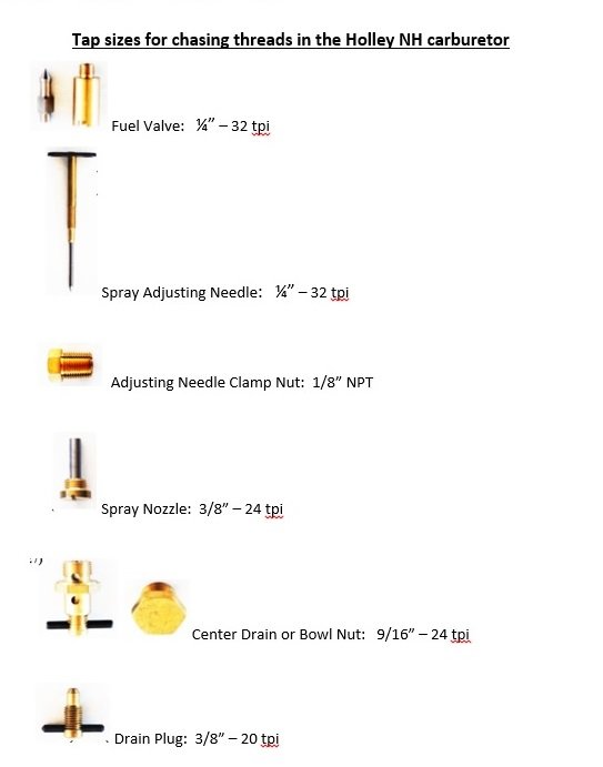

I hope this will help you...
Rich C.

1/4-32 is a very common thread size in carburetors.
Not in NH but 5/16-27, 3/8-27 , 7/16-27 are common.
3/8 are usually standard 16 or 24 but many are also 3/8-20.
The fuel fitting is standard 1/2-18 except for some early 1/2-20.
The bowl fitting on early Kingston is 17/32-18.
The bottom thread on NHs is 9/16 -24, which can be a hard and expensive size to find.
For some reason ebay usually has some used ones for cheap.
If you really want to save an NH body with bad threads you can tap it 5/8-24, cut the male thread down and solder a bushing on it threaded 5/8 -24 and enlarge the hole in the bowl.

Andre, if you have a lathe it is easy to do the bushing or ream the hole and tap it 11/16-24, lock tight a bushing with female 9/16-24 threads in and use the original drain/bowl fitting.

Post by AndreFordT » Fri Jan 15, 2021 3:11 am
Thanks Stan, thanks all,
Just a question: What mean "tpi" behind the thread size on the sheet?
With the sugestions of Stan I will work something out and will come back with the way I did it.

Post by ABoer » Fri Jan 15, 2021 7:31 am
Andre', TPI = Thread per inch . Aantal gangen per inch .

Post by StanHowe » Fri Jan 15, 2021 3:54 pm
The Imperial thread system is slightly different in nomenclature compared to the metric. Metric sizes are in MM with the thread pitch following. 14 1.25 or 1.50 etc. Imperial is the size followed by the TPI - threads per inch. 1/4 x 20, 1/4 x 28 etc. There are two "standard" pitches or TPI for each size, noted as coarse and fine. Fine is often noted as SAE. Then there are all sorts of "Special" thread sizes in each diameter. 1/4 x 32, 1/4 x 40 etc. Sizes smaller than 1/4 are noted either as fractional sizes - 3/16 x 24 - or single number sizes 10 - 24, 10 - 32 etc. It can really get confusing.
