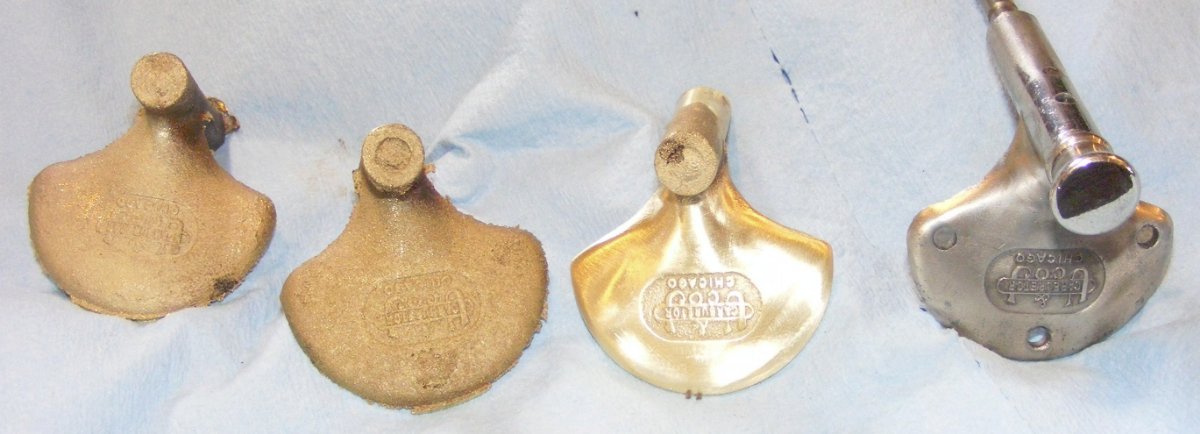

The original Stromberg connector is a brass tube similar to standard brass tubing with a wire inside it. It works pretty well but only if it doesn't have any fairly sharp bends. The newer ones have a standard wire cable with a wire inside, just like the choke and throttle cables, heater controls etc, used on cars in the 40's and up. Some use a motorcycle type cable like a motorcycle clutch pull cable.
The coolest one, IMHO, tho, is the U & J control. Mike Lebsack and I reproduced those a few years ago. I'm out of them except for one I kept. I also have the only known NOS U & J carb which came with the original we used to repop them. On the ones we reproduced I changed the ball stop to make it easier to assemble with out a special tool. I need to get more made.

Is the U&J unit intended for the later cars that had a real dash or instrument panel? It doesn't look like it would wrk with the cars that just have a flat piece of wood.
Re: Cockpit Choke for Stromberg OF?
Posted: Sat Jan 23, 2021 5:20 pm
by StanHowe
It will work with pretty much all of them but probably better with the later steel body cars with a dash.
