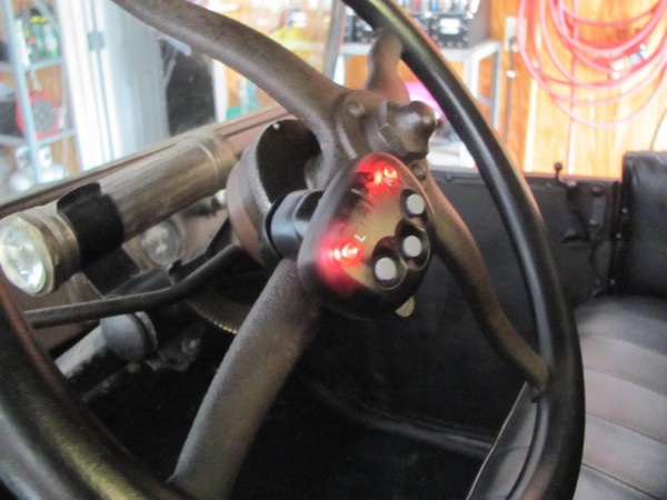

This is the same China version unit mounted on the steering wheel spider. The China version comes with this control for handle bar, but it fits neat on the steering wheel and simple access. Make your own rear bracket to mount. On the '24 made a mount to fit to the spare tire hanging off the center. The signal is centered on the T that way.
