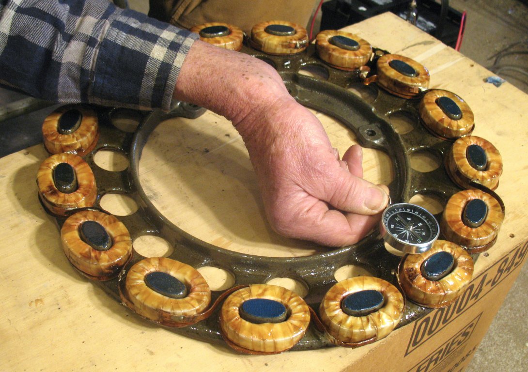

Looking great Steve.
See you did a magnet test. Did you do a polarity test too?
The polarity test (N-S;N-S; ... 16 times) will tell you for 95% if your loop will work or not.
the 5% left has to do with the connections in the car and the way the magnets are charged. (weak -strong?)
Yes, I did. N, S, N, S, N, S, etc.
This picture is also a warning against stupid hand cranking.
:D

Nice job on the coil ring, Steve ! Knarly looking wrist though !

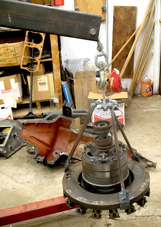

Gee, I actually accomplished something today. As the fleeting years bring increasing feebleness, I resort more and more to machinery in place of muscle.
The new piece of equipment I finished today is a magneto/flywheel/transmission lifter. It should ease the chore of getting the right magneto gap.
