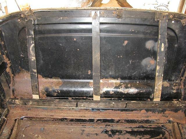

What does the wood frame look like and how is it attached to the back springs?

I have the wood pieces and a Snyder’s spring. Any pics would be appreciated of these wood sticks fastened together.

This is the only one I can find so far in my stash if I find any more I will post them. Jim

That’s perfect, thanks. Tack together like a pallet and bolt to the rear sheet metal. Now how does the spring attach to the wood frame?

Expand the photo and note remnants of heavy canvas tacked to the upper wood rail, those pieces were looped around the spring frame.
Adjust the loop length to hang spring in position, do the seat base first so the backrest spring and backrest upholstery clears the seat so it can be removed.
