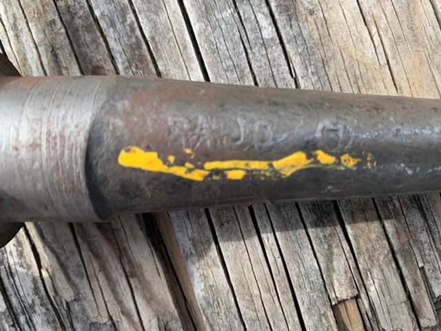

Are those marked Rajo? Dan

The reason I asked if they were marked is I have only seen one set marked Rajo of the 12 sets I have had. Dan
Re: Rajo self steering spindles
Posted: Sun Feb 07, 2021 7:17 pm
by Dan Hatch
Here they are
