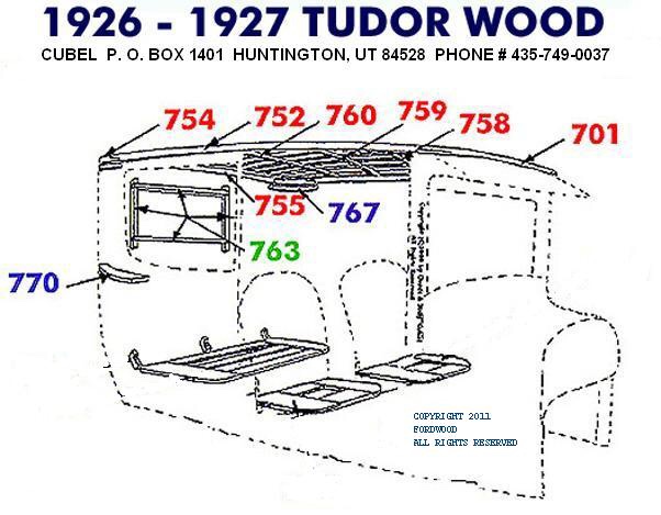

I have a 1926 coupe and I believe that the windshield on the ‘26 Tudor is identical to the ‘26 coupe. You should include a photo, for I have no idea what you are talking about, because there is no wood in the ‘26 windshield, to rot. 1926 is the first year of the totally redesigned “improved” Model T with all steel bodies. Other than the 1926 Fordor, which had a wooden framed body, the other 1926 closed body styles were all steel, with the two piece all steel windshield frame. The top piece with the hinge went across the top and the other piece, a three sided frame that the glass slid into, attached to the top piece by means of heavy tabs on each end of the top piece that slid down into the bottom piece and were secured by two countersunk machine screws that screwed into the side of the lower frame into two threaded holes in each top piece tab. There were also two large headed, decorative threaded oval headed countersunk machine screws that go into each side of the face of the frame. In all, there are six screws that secure the top piece to the bottom. Jim Patrick

Perhaps Steve is using "rotted out" to mean rusted out.
Re: 26 tudor windshield
Posted: Sun Feb 14, 2021 7:31 pm
by jiminbartow
Allen, I’ll bet you are right! Jim Patrick

Yes, I am talking about rust. I guess my question is; has anybody cut the side piece off and replaced it? If so, how did you go about it, where to cut and how to re-attach? I don't know how to post pictures, but Jim's illustration is the windshield I have. I don't really want to look for a different one if I can fix this one! THANKS for any help, STEVE
