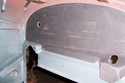

firewall pad. Cardboard or something a little more water resistant? You guys make your own or purchase?

That molded fiberboard gas tank insulator for the '27 cars is a very nice reproduction, fits fine. The earlier Improved Car just used two strips of webbing that were riveted at 4 places to the cowl. You can tell if you car is later, as those tiny 4 holes will be missing from the upper face of the cowl.

These should help you, pieces for all but Fordor:
All '26-'27 used webbing pads above the tank.
Only some '26 used webbing pads behind the tank. You can tell by holes punched in the cowl face for these pair of pads.
DCP_2961 (526x478) (526x478) (526x478) (500x454) (499x453).jpg (106.95 KiB) Viewed 2286 times
The later 26-27 did away with the two webbing cowl pads, and used the molded fiberboard insulator.[/b]
above tank webbing .jpg (91.23 KiB) Viewed 2286 times
All used the rubber insulator strips on the support rods that hold the tank in place.

Looks like I have the holes, and rivets are still there
So I can now say I have a 26 - not a 26/27? :D

Excellent info. I did not even know they were there to begin with 'cause it had nothing.
I see now that even my question was wrong. Finally got 2917, 2918, and 2918A straight.
