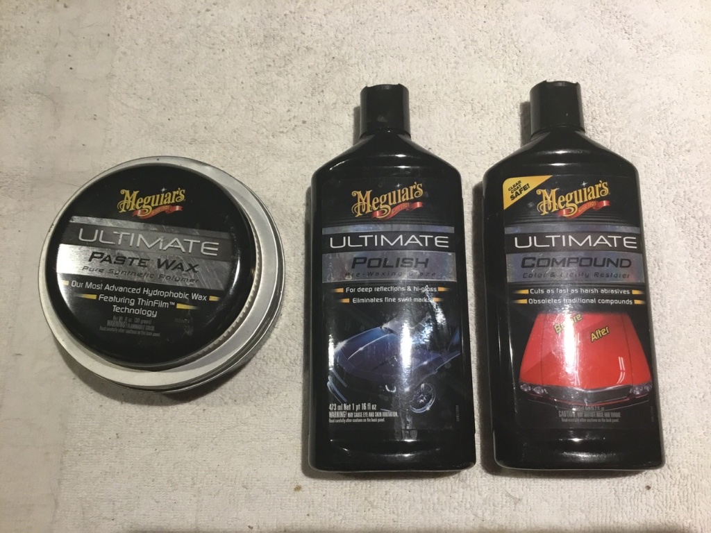

by jiminbartow
The paint I see under the dirt and dust looks pretty good. After washing it, you should try using rubbing compound to remove the oxidation and renew the finish. Done right, you might be able to obtain a mirror like shine. Meguiar’s makes a great rubbing compound. Jim Patrick
