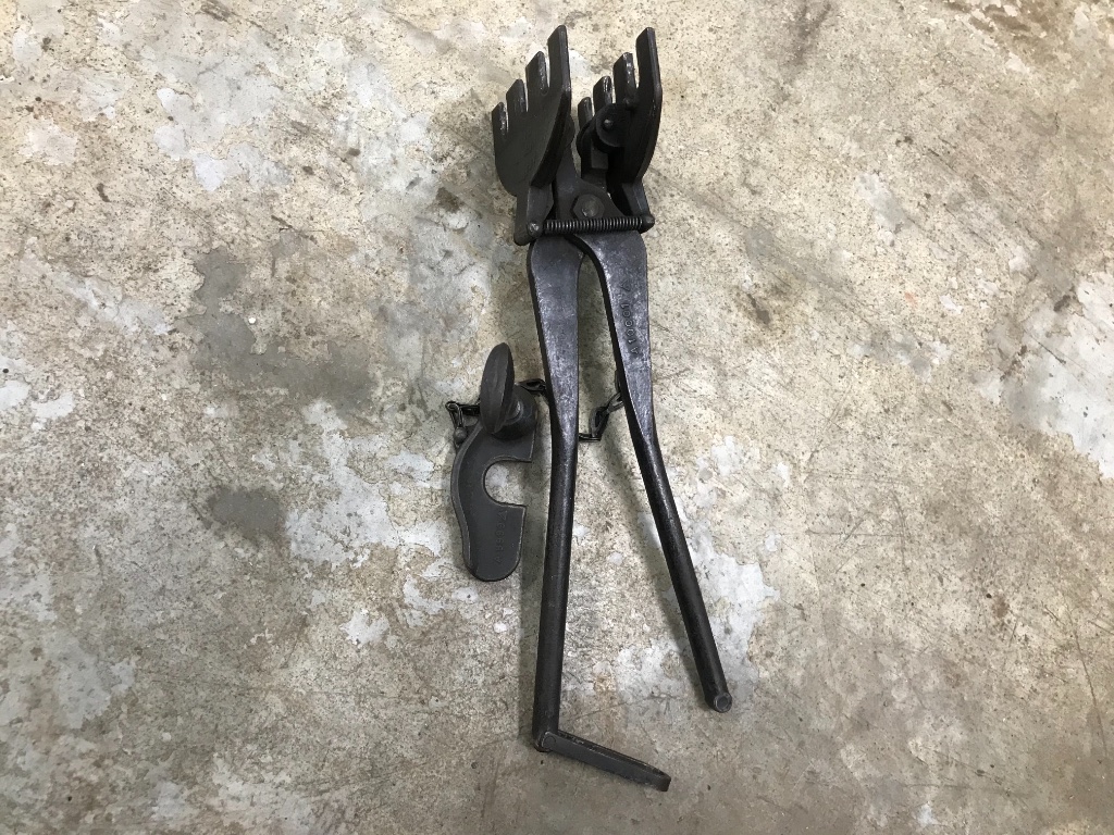

I have had good luck using three separate pieces of wire. One on each band. As I lower the hogshead at an angle with the rear lower than the front onto the drums I cut each piece of wire one at a time as each shaft engages the band ears.
This period tool works amazingly well to compress the band springs. Although it won’t work on ‘26-‘27 hogsheads. One of my better Hershey finds!

I have exactly the same tool that Ed shows. I will never install a hogshead without it! Once you have the band ears tied together with the plastic ties and the springs compressed with the tool, the hogshead just drops right into place. Easy peasy.

by RustyFords
The Ford script u-shaped band tool works better than the modern copy that Lang's sells.
It has slightly different dimensions.

by John kuehn
Rusty Ford is right about the copy of the band tool not fitting well. I have one of those and wound up not using it. I can’t understand why the repo tool can’t be made to the same dimensions as the original.
