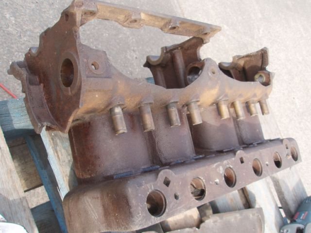

I was recomended a company to weld a crack in my engine block. When he started welding he quickly found out that the steel was rusted thin. Apparently there was something sticky fluid inside the cooling channel that caused this. This is at the top of the engine block.
My question is, is it worth fixing? It's the original engine block from my great grand fathers car and the crack is probably the cause to why it was parked. I do have two other engine blocks that looks like they're in fairly good condition that I got when I got the chance to buy a lot of bodies and body parts, but this engine block is matching numbers with my frame.
If it can be fixed does anyone know how to do it?

Great great grandfathers?
Matching numbers?
If it were mine, I would try to find a way to fix it. Model T's don't have a pressurized cooling system, so it does not take much to keep the coolant in.
And definitely don't throw it away.

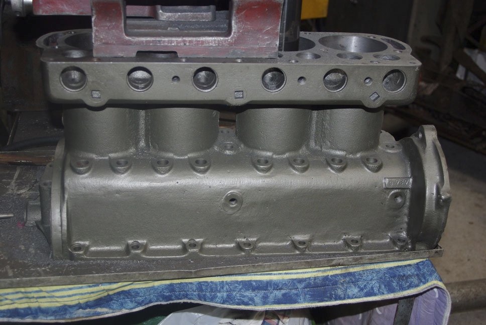

You tell me I stole these pictures from a thread a couple of years ago
Metal Stitching would be the best repair . :roll:

I would look at between 2-3 cylinders in the top of the oil galley, 26-7 blocks crack there also from soft plug to center main bolt, another place is exhaust valve into the cylinder. The 26-7 blocks are still common I would find a better block and mill the water jacket side to renumber it to your title. You could get a ton of money in fixing your block and then look like Frankenstein after. Just my thoughts!

Stitching is a good method to fix a block without causing more damage, however the technique does need some thickness of metal and is not cheap. Fixing the cracks in my 09 block cost close to $1000 but then it was probably worth $6-7k. With a 26 block, I think I’d find a good one and renunber it.

Tonys suggestion is a good one. Find another good block of the proper style and year and transfer the number. Yes your block can be welded. But to do it correctly, with proper pre-heat will probably melt out your main bearings and you will need to re-pour them. No problem if you were going to have to re-pour the mains any way. From the looks of the metal at the crack, stitching is not a good option. Yes a patch could be made and stitched into place, but it would be very, very, very (yes 3 very's) time consuming. Arc welding that crack with nickel rod is not going to happen. Making a patch and brazing it in place is also an option, but the welder needs to know what he is doing .... The location of the crack is far enough away from the main bearings that a pre heat good enough to braze the patch should not melt the mains. If you try to fix it, you need to do a very good clean out of the water jacket. Any rust or trash inside the water jacket will be sucked into the weld and cause alloy problems as well as porosity (pinholes) in the weld. You also need to make sure that the rest of the block is worth the effort ... wishing you good luck with the project........

I do not agree in trying to fix that block unless it is a rare early block. Chances are there is more damage and rotted areas ready to cut loose then what you are seeing now if that area is that bad. If it was just a crack, it could be fixed with slow cure JB weld or similar product. Even if you did try and fix, it would need a better cleaning then hot tanking, there are places that do acid bath cleaning or oven cleaning. There is 100 years of grease, oil and rust to deal with when trying to get weld to stick to the cast iron.

Usually the head cracks at the top along the water outlet passage. About 50-50, the block gets thin and rusts rather than a freeze crack, or it cracks easily from being thin.
There's probably as many out there with repairs as not.
I'm with Mark and Joe, fixable, maybe, worth the time and effort...no.
IMHO, just having the matching block under the workbench is goodnuff ;)

The block looks not only cracked, but also rusted through. The metal around the largest voids looks very thin. I don't think you've got much there to work with.

It can be fixed, with much effort.
You could even hammer up a copper water jacket & solder that to the block if you wanted to. But that would require much soldering.
You can probably drill out that rotten area and drill & pin pretend metal stitch it if you wanted to at home. I've done that on cylinder heads that nobody else wanted to repair.

A typical straight hairline freeze crack is one thing to repair and not real difficult. This crack is another story. The inner walls of the block look to thin and really to far gone to repair.
Yes it could be repaired but what it would consist of to do it doesn’t warrant the time since the inner water jacket condition doesn’t justify it. An open valve or very early T block is one thing to try to save but not a later common block in this condition.

I'll take the best engine block of the other two and renumbers it in the first hand and then I see what will happen with the original engine block, I'll definitely don't going to throw it away. The body work will cost a fortune on my project so maybe I'll get the original engine block repaired in the future, but then again it's hard to find someone to weld and repair it today...

If that block came here, I would scrap it immediately and select a replacement from my collection of identical blocks that are not in such poor shape. If the number is a problem I would destroy the number on the old one and stamp the number on the donor block after milling the old one off. Blocks in this condition can be saved without a doubt, but it only makes sense with rare and valuable early ones. Later blocks can be had for far less than the cost of a proper repair. I understand there are not as many in your part of the world but they can be shipped. I will give you one but I am a very long ways away from you. Good luck in your project.
