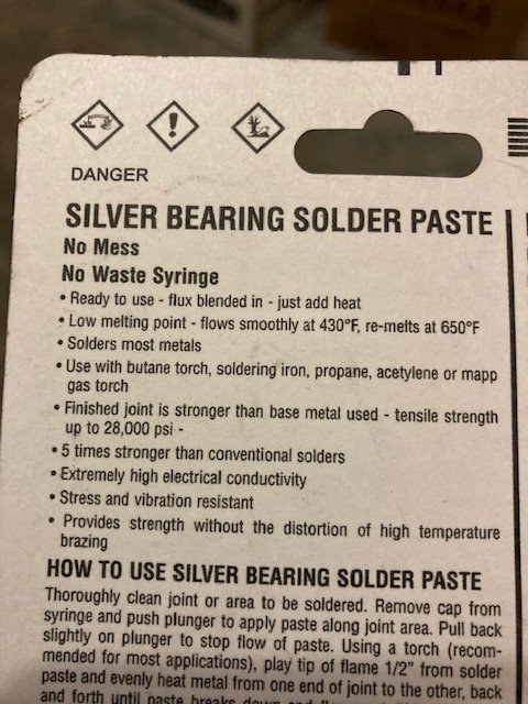

I just found a product that helps with this kind of repair. It's Silver Bearing Solder Paste. It comes in a tube and is silver solder particles suspended in a flux. melts with a small butane torch. Also makes a great tin for heavier solder. Found it at Homedepot

I will issue my opinion as gently as possible: Silver-bearing solder is soft solder and is the very last thing you want to put on a brass fracture/joint which is under stress.
If you do use it, you will want to keep a "puddle" of it at least on the inside of the part. True silver solder, like a weld, can be worked down to just the parent metal and be an invisible repair. Not so with silver-bearing solder.
