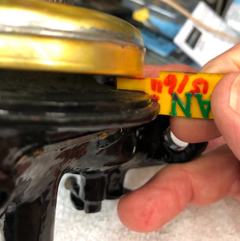

Hollow brass or shellacked cork? When selling the float, be sure to measure from the flange to the top of the float. Jim Patrick
Re: Bad carb float again?
Posted: Sun Mar 14, 2021 1:59 am
by ivaldes1
Hollow brass purchased from a reputable vendor. I think I measured and re-set the float correctly per the diagram. It has been working fine for the last few years so I am at a loss as to why it suddenly has developed a problem.

Dan, it looks like your gauge is upside down. Square side should seat against the flange and round side should face the float. The way you have it, there appears to be a gap under the gage on the flange side, which will make the gap wider than 15/64. Jim Patrick
