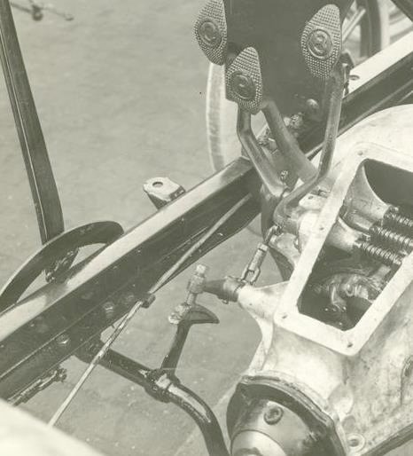

Hi Larry,
First, I will state that I do not know. The picture below does not show that detail.
One can see that the line does sit inside the frame as it runs forward from its clamp, but the area of the wood block is not in the photograph.
This pictures suggests that the gas line is routed between (or UNDER ???) the wood block and the frame.
Not knowing the sequence of assembly at the plant, we can only guess (using Good Manufacturing Process) WHEN something as long and fragile as the gas headlamp line was installed on the chassis, after the engine but before the steering column? Who knows. Early cars, without the holes in the radiator for the gas hose, apparently had the gas line run below the frame, as shown in these pictures.
What year are you working on, Larry? Your '13? Good luck with your project, Bill

Hi Larry,
Here are some pictures of my unrestored 13 Touring showing the gas line for the headlights running under the wood block at the rear engine mount.
Then it runs under the wood block for the steering mount.
Hope this helps.

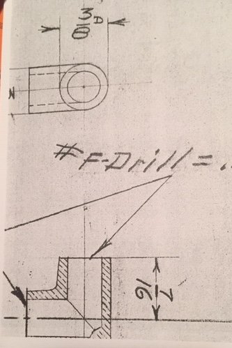

by richc
Here is the original plated tee Larry referred to.
Rich C.
Re: Headlight Gas Line Routing
Posted: Thu Mar 21, 2019 9:26 am
by Original Smith
Thanks for posting Rich. These photos are important, and yes that is the Tee we are planning to make. The O.D. of that Tee is 3/8, and of course, the I.D. is 1/4.
