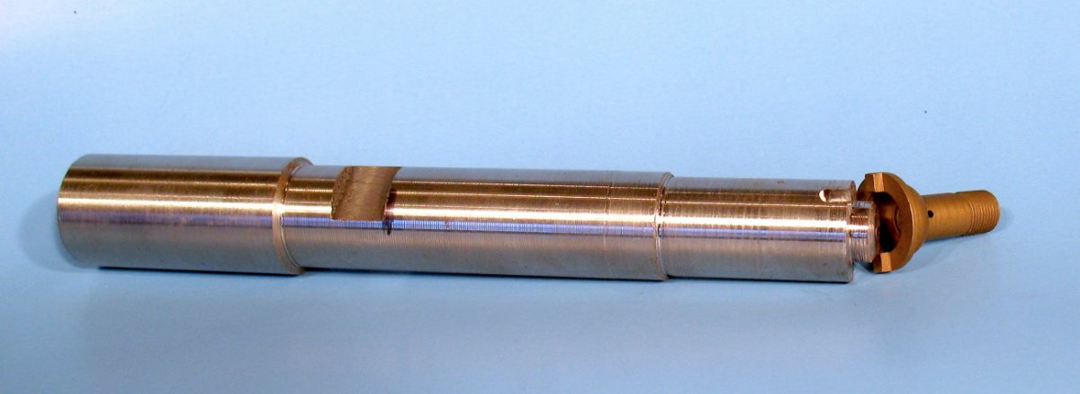

Several years ago I borrowed the use of a lathe and a mill at the local juco and made some carburetor tools. I used a junk axle shaft.

Now that's ingenuity!
