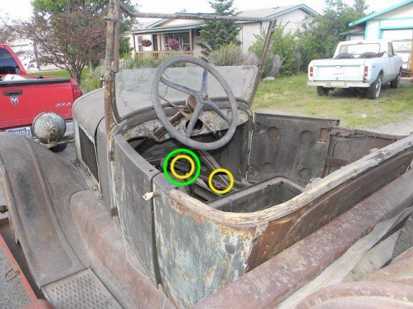

Been a while since I had my ‘27 roadster... but seems to me that mounting bracket circled in the pic above simply supports the hood sill plate and/or hood latch...?
As for the coil box... yur going to have a he// of a time fitting it and the fuel tank under there

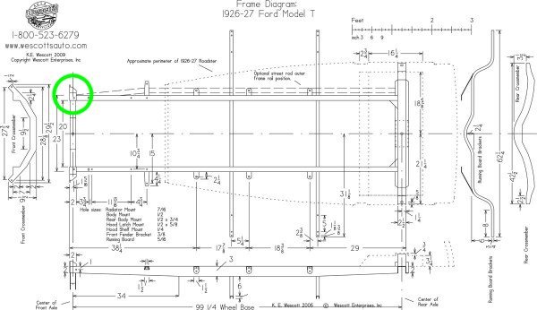

When you say "the 'wider' mount up front is for the hood clasp", I assume you are referring to the "circled green" in the car photo, not the diagram?
The "circled green" in the diagram is for mounting the front of the front fenders?

Tom, the wider brackets at the front frame crossmember that you marked in green are for the 26-27 front fender brace. The 26-27 radiator width is the same as earlier radiators. The 26-27 firewall/cowel is wider than earlier t's so the 26-27 hood is different from the earlier ones. The Rootlib catalog page you posted are hot rod 3 piece hoods, not stock 4 piece hoods. The earlier hood will not for the 26-27 body. You are over thinking this and have received some conflicting advice.

As Jeff posted you won't need the front bracket unless you put on 26-27 front fenders.

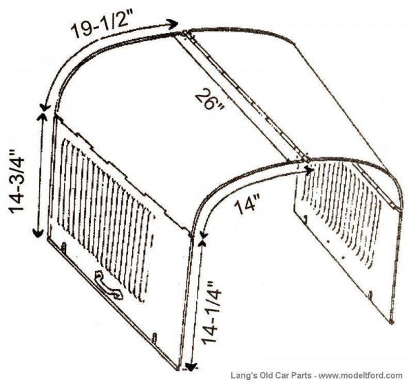

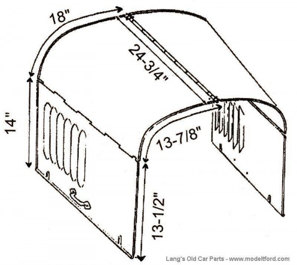

Rather than just guessing and possibly giving Tom the wrong answer, I thought I would add his question here. In an e-mail he asked, " ...about the front (radiator side) measurements for
those 2 hoods. Why is the radiator side on the '24-'25 13 1/2" vs the
'26-'27 14 1/4" when both can use the same radiator?"
Note he is asking about the front of the hood which is 3/4 inches longer on the side panel than the 1924-25 hood. And the top front of the hood is also 1/8 inches longer. [Side note the rear panel edge is also 3/4 inch longer -- but that one should be due to the larger cowl on the 1926-27 cars].
Reposted from above -- from Lang's catalog:

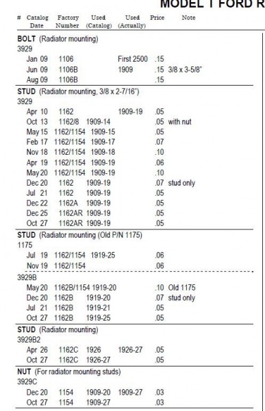

Tom correctly points out the the 1924-1927 cars use the same radiator. And the nickle radiator shell is listed in the Price List of Parts from 1925-1927 as the same part number.
So far the only item I have found that is listed differently is the stud that the radiator mounts to. A scan from Bruce's Comprehensive Encyclopedia is shown below. For any commercial use -- please contact Barbara McCalley or to order a copy of the excellent 2 CD disc material see the posting at: http://www.mtfca.com/discus/messages/822076/844722.html
Bruce McCalley - Price List of Parts
You can see that the 1926-27 stud has a different part number 3929B2 and Factory Number (Drawing number) 1162C than the 1920-1925 stud which has part number 3929B and Factory Number 1162B.

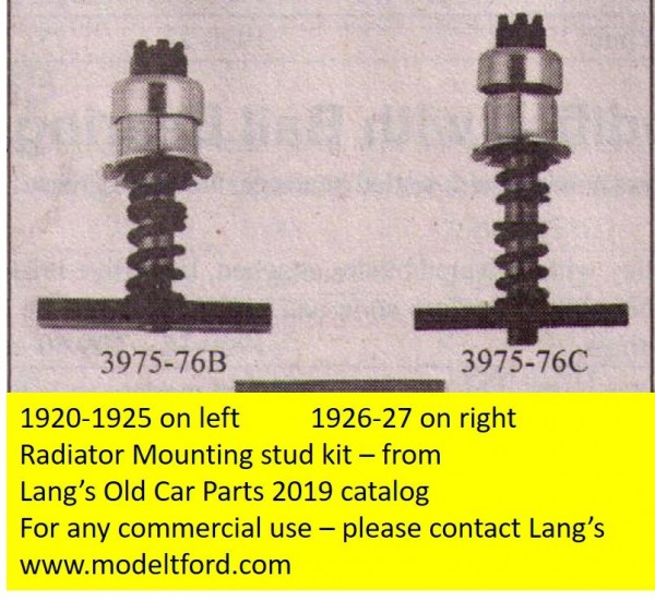

Unfortunately the length of the stud is NOT listed. However in Lang's Old Car Parts 2019 catalog they have the illustration shown below:
"IF" the photo shows the two studs at the approximate scale, then perhaps that extra length on the hood is due in part to the extra height the radiator is mounted?
But I don't have an "Improved Car" to check out that theory/guess. So if someone who has both a 1924-25 and a 1926-27 could check why the hood panel is 3/4 inch longer in the front that would be greatly appreciated. Or if someone knows the answer and doesn't have one of those cars to compare -- that would be great also.
Note -- "IF" it is the radiator studs that cause all or most of that 3/4 difference -- then using the 1920-25 studs to mount a radiator on a 1926-27 car may throw the hood alignment off. Again -- this would be another time when using the parts from the same year range usually makes assembling the car easier.
