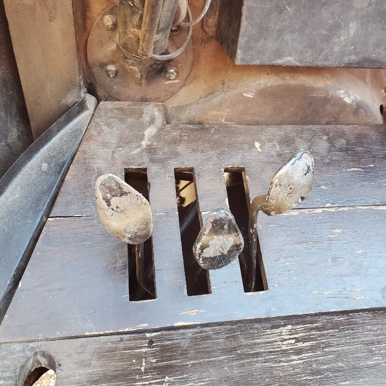

I bent my pedals out using a torch to better accommodate my 10 1/2 D

by John Warren
Cool seeing the tool.... Haha 😄thanks

I will agree that you can easily change the floor boards. The 26/27 pedals are just better and safer, unmodified.

john warren that bend is a fantastic idea... I will do mine that way....thanks

No regret, and if someone wants to bend them back sometime in the future, they can.
Much, much better for me.

John Warren’s idea is a great one! With my large feet I have to remove my size 13 shoes to drive my T’s. This is how I learnt
that the pedals get real hot and I need the rubber pads!!
