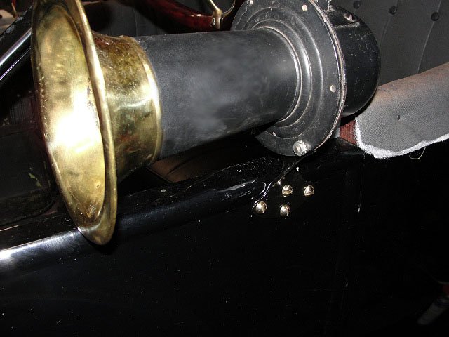

The Delco-Remy 18B is not an ahooga sounding horn, I have one and it works really well, and is a throatier "Beep,Beep" horn. Just need the bracket to mount it under the hood.
Ever hear the klaxon on an Aircraft Carrier? that's sort of the same sound this one makes (and it's loud too).
Now if you want an Ahooga horn, get a Spartan, those are ahooga horns, they're from a Model A but since it will probably be under your hood, no one is going to see it, so who cares. However, if you want an ahooga sounding horn that were period aftermarket accessories for Model T, get the Hand Klaxon, those are also ahooga horns, I've got one on my 22.

So I found a Spartan that needs minor work. Hope to fix it soon. The motor works. It's identical to this one in the video.
https://www.youtube.com/watch?v=Un31ggR ... 05ROADKING
I'm now needing ideas on how and where to mount it. I intend on keeping the original horn and adding this Spartan.

Under the hood works best. The Spartan uses a single bolt to hold it to the Headlight Bar on a Model A, but will work with Model T mounting brackets that use the diaphragm bolts also.
If you need parts for that Spartan, Snyders Antique Auto Parts, sells every part for them including complete new horns...the new horns are expensive, but the parts are really reasonable. You can buy pretty much everything to tune up an old Spartan for about $35.00, including a new diaphragm. Use the link below.

Re: Klaxon 18B Delco-Remy
The one on his car is adjusted too bloody tight, which is why it sounds so flat. The adjustment on the armature shaft should be light, you want it to spin up fast, so to do that it has to be just a wee bit loose, that's where the "Ahoo" sound comes from. The "Ga" sound is the motor spinning down slower than it spun up when you take your finger off the button. Which is why the armature is so bloody heavy. So to get it to sound that way, the adjustment on the damper screw should be kind of light. It'll take some playing with it to get it to sound just right, but once you do it'll keep stay tuned for a very long time.
That felt pad also needs to be kind of soaked with a light oil (WD-40 works, but better still a good grade of clock oil or even better a light silicone oil works pretty well too for that matter and doesn't gum up either like the organic oils tend to do). But you don't want that felt pad so sopping wet with oil that it drools it everywhere, just want it wet enough to keep the shaft bearing lubed...also apply a drop of oil on the bushing at the other end of the armature shaft where the Motor Horn Ratchet is too (that's the bumping looking wheel that runs against the nub on the diaphragm). Those two areas are generally what keep these horns from not working and or sounding properly.
The ones for outside the car have a flared bell like on my car's hand klaxon and are usually painted black (hot rod folks tend to chrome plate them) with a screen just behind the flair. But the ones like in that video are always under the hood and it looks like it has a 26-27 horn mounting bracket on it too.
