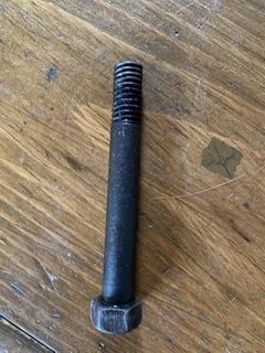

Turns out the bolt came out in one piece and the bottom most threads are all totally stripped. I’m going to pull the head off the engine tomorrow afternoon after work to see what’s going on inside the back two cylinders and see if the top of my block is good (hopefully it doesn’t need to be milled).
It looks like the bolts are missing some threads compared to pictures I see of other T head bolts, maybe it is cracked deep inside the head after all. :(
How do I measure the bolt to see if it’s missing the bottom?
How do I determine what bolts I need? Seems like there are different bolts for different heads.
Are the bolts supposed to bottom out?
How do I determine if I need to retap the block threads?
What thread tap and drill should I use to retap the block threads (if necessary)?
What should I do immediately to prevent any further damage to the engine? (Remove head, oil, and coolant?)
Here is a link with pictures of the stripped bolt. I’m not sure if it’s cracked. https://imgur.com/a/G0omH3a
How should I proceed?

1. Place the damaged bolt next to the other bolts. If it is shorter, you have a problem. When I worked for the Railcar repair industry, this was a common occurrence and our machinist had a special type of welding rod that he would slip into the hole and touch to the broken stud. The rod would weld to the top of the broken stud, but not the walls of the hole. He would then grab the rod with a pair of pliers and unscrew the stud out of the hole. I wish I could tell you more about this special rod.
2. Again. Compare the bolt with the other bolts. If the threads are the same, no one in the past has retapped it a different size or tap. It would be advisable to buy an entire new set of bolts, in case some of the other bolts are fatigued or stressed and about to break. I have never had trouble determining what head bolts to get. There is only one type for the Model T engine.
3. No, the bolts are not supposed to bottom out unless the holes are full of crud and rust. It would be a good idea to blow out all the holes with a high pressure air nozzle, but not before covering each cylinder hole to prevent the rust particles and crud from entering the cylinders. Clean off the head with lacquer thinner, and let dry, then tape over each cylinder hole with several strips of 2” wide clear packing tape or duck tape. Some would recommend stuffing rags into the cylinders, but small particles of rust could fall into the cylinders past the wrinkles of the rags and become lodged between the piston rings and the cylinder walls and badly score the smooth cylinder walls if allowed to remain. Tape over each blown out bolt hole as they are cleaned to prevent contamination by debris from the other holes.
4 and 5. Unless you discover that the female threads are damaged and plan to repair them using heli-couls, no drill will be needed. It is more likely that, after the holes are blown out, the threads will need to be chased with a bottoming tap (not tapered, so the threads will go all the way to the bottom of the hole). If you have a set of taps, the correct TPI (threads per inch) can be found by holding the tap up to the threads of the bolt. If the threads match and seat in eachother, you have the correct TPI. The tap with the correct TPI that will screw into the hole is the correct bolt size. It is possible that a past owner could have re-tapped the hole for a larger bolt.
6. See 4 and 5.
Good luck. Jim Patrick

So the threads on the bolt should be 7/16ths of an inch, 14 turns per inch. So that would be the bottoming tap and thread cleaning tip I should buy.
