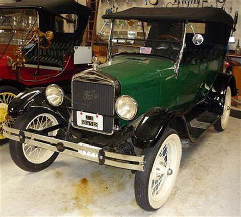

Bottom line. When doing ANYTHING on your car...ask yourself, does it make YOU happy. We can chime in all we want, but if you take our advice and are unhappy with the results, the purpose of having a Model T that is a reflection and result of your taste, decisions, expense and hard work, that is supposed to make you happy, is defeated.
For instance my ‘26 coupe is supposed to be painted “Channel Green”, but the examples of what people thought “Channel Green” looked like, that is based upon old faded surviving examples, appears more to me to look like a dull olive drab, which I hate (see first photo). So do I want to be authentic, according to what others say and be unhappy with the results, or do I want to paint it my version of what I think Channel Green looked like and be happy. I choose happy and would paint it a brighter green that I like (second photo). This is a BIG decision because preparing a body for painting is expensive in time and materials and is the most visual part of your efforts, so, much thought has to go into it before you are committed. Since no one is really sure of what Channel Green looked like, I have a lot of leeway to choose what appeals to ME. Same with Windsor Maroon. The very dark purple looking color that many portray as Windsor Maroon, is just too dark for me, so I can use the excuse that, no one really knows, and paint dulls, fades or darkens over time, etc. to choose a brighter color more to my liking, that is a reflection of my taste and most of all, that makes me happy, instead of regretful. Jim Patrick
PS. Since I have a 1926 Fordor that will be painted Windsor Maroon when the time comes, I have given this a lot of thought and have chosen my preference. The third photo of the ‘26–27 dash is what I would interpret and prefer as “Windsor Maroon”. First of all, it is maroon and not a dark burgundy or merlot and it is bright and beautiful, at least to me. But, to each his own. Good luck on your choice
