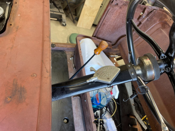

Has anyone mounted one on a 26/27 yet? Column has horn wire channel which is right in the way of clamping it .

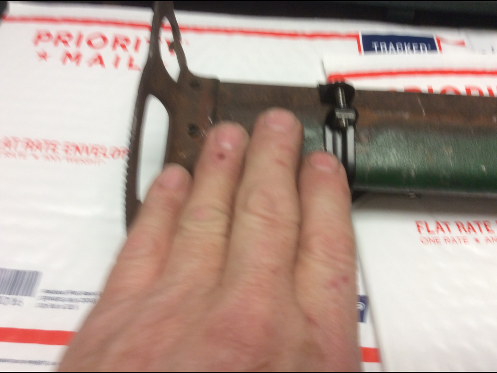

4 or 5 fingers down from the quadrant is about right Danny. I can take a picture of mine, it’s on a 1926

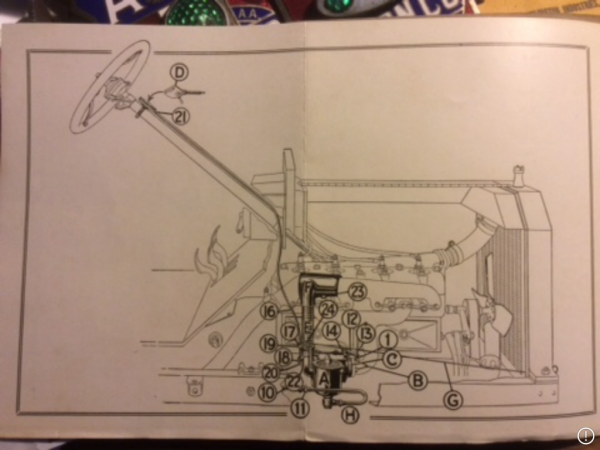

The instructions say about 10” below steering wheel nut

Re: Tim’s stromberg choke remake
Cool
So right above the horn trough! Gotcha
