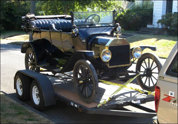

I just bought a 1913 Model T and I am going to pick it up this weekend. I have a large enclosed trailer so the car will be well protected, but I want to make sure it does not move around inside the trailer. I only have hooks in the corners of the trailer so I was planning to run the straps around the axles of the car to hold it in place inside of the trailer. I have hauled tractors and other cars this way, but looking under the Model T the axles look a little skinny and fragile....but then again it does not weigh very much. Any advice or words of caution about hauling a Model T this way?
Thank you.....

Congratulations on your acquisition. Others will have different opinions, but I prefer to tie the car down by the front and rear springs. This prevents the bending of either axles which bend easily, and it prevents the car from bouncing the whole trip.

Do not pull front axle forward and rear axle backwards.
Pull front axle back and rear axle foreword.
Better yet, use wheel nets and pull straight down.
Keith
Re: Transporting a Model T
Posted: Thu Apr 15, 2021 2:50 pm
by ivaldes1
Go under the axle with your strap, then up and hook to the frame.

Congratulations on your purchase. Use the springs and be sure to cross the straps. Jim Patrick.

I believe the car should be tied down. Wheel baskets do this.
Wheel baskets also allow the transported car to move on it's suspension, just like modern cars are hauled. Tying down to the frame means the car flexes on the tiedowns as the suspension works over undulating roads. You run the risk of the tiedowns disengaging as they are alternately loose and tight.
The longer the strap, and the lower the angle to the floor, the less the car is tied down. Sure, it can't go back or forward, but is free to dance about a bit.

With a 1913 T and the early type above axle front wishbone I would NOT Tie to the front axle. Tie around the spring up by the frame and cross the straps. Same goes for the rear, tie around the spring up by the frame and cross the straps as shown in a prior posted rear picture.

The 1913 has no radiator apron so you can feed a short strap (such as a two-foot strap with metal loops at both ends) through the gap between the radiator and the front cross member, wrap the short strap around the front frame cross member. Tie your front straps to the metal ends of the short strap, this will get your straps tied to the frame, the most secure member for such purposes.The front axle is tied to the T only by the wishbone ball and socket joint, far too weak a connection to handle the torque generated by a lurching automobile. Even wheel baskets or nets on the front are still reliant on the ball and socket joint of the wishbone, not good enough.
In the rear there is less of a problem. The rear wishbone connections are much stronger, were designed to handle rear-thrust torque. It is possible to wrap the tie-downs around the top of the springs, up closest to the rear frame member. Cross the tie downs left to right, right left, to handle side to side sway, and all should be well.
Just to be sure, set the parking brake, and place wheel chocks in front of the front wheels and behind the rear wheels, assuming you drove the car into the trailer front end first.
The above method gets your car secure without having to take hours to secure it in place with numerous straps to handle multi-directional torque.

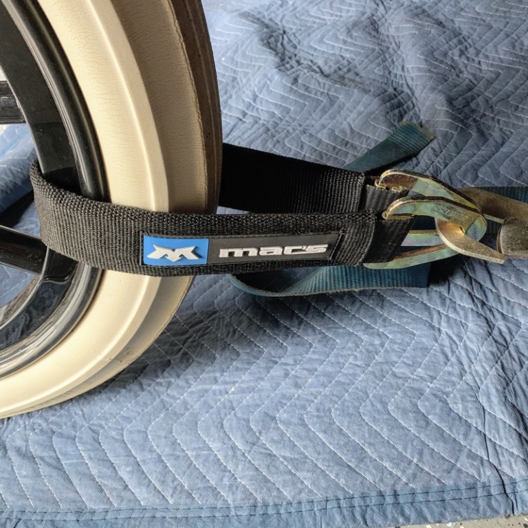

I just loaded this 1915 Model T Runabout up
in Bolton, Massachusetts.
Going from one family member to another 😉
This trip will be unique 🤔
I have to pick up another Model T in
Michigan that is also going from one family
member to another.
Since 2006 - I have personally transported over
(400) Model T’s of just about every body style
and configuration.
A few years ago - I standardized tie down
Methods for all Model T’s & Early Brass Cars.
If the wheels - spindles - bearings are secure
and in good order:
Mac’s axle straps thru the wheels
Ratcheting nylon straps from the wheel
Back to the center of the vehicle in line
This holds the car together
This helps keep the car from “ walking “
Across the trailer floor
I have etrac installed about every four feet
Width wise across my trailer
FJ

Wheel nets are the best option - let the original suspension operate - our country's roads are atrocious !

I'm not referring to "U-Haul" wheel nets - I'm talking about Mac's & my custom made for 30 x 3.5 tires wheel nets. I've got thousands of miles towing with wheel nets - never had one loosen or remove itself - one needs to frequently check your lashings though !
