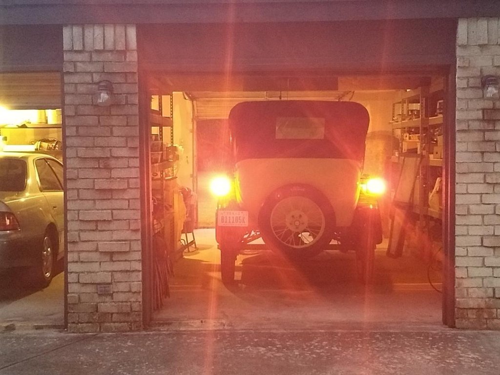

Goggle motorcycle tail lights. and search amazon as well. a lot of small brake/tail/run lights that might work. some are flexible and can be formed around a fender or other location. also the vendors sell brackets that attach to Your top tie down posts and takes a standard model T tail light. would look better on a brass car than what I have. had some made for My 26 that use IMG_20180626_203930210_LL.jpg[/attachment] HF trailer lights with dual lens red on rear orange on front. use it for front and rear turn signals. rear tail and stop light. Picture is washed out. color is bright red. stop light is on. front of light is amber it is washed out too. but it is very visible day and night.

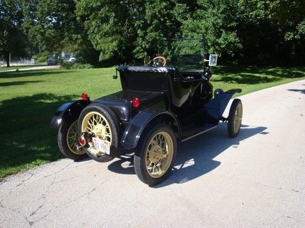

This is something I have struggled with myself. If the tail lights are too unobtrusive they somewhat defeat the purpose. I have done 3 iterations of tail lights myself, which I will share in a moment. For my 1915 roadster, I use electrified side lights as the front turn signals. While I have LED bulbs in the tail lights, I use regular filament bulbs in the front turn signals, so they don't hyper flash. The vendors sell a tail light bracket that attaches to the top saddle iron, which you can then use a standard electric Model T tail light. I like this solution best for a touring car, as it is very visible, and still "Model T-esque". I think it works less well on a roadster, as the roadster saddle arms are further forward on a roadster. Here is he vendor bracket on a roadster:
Here is a similar, owner built bracket on a touring car:
Here is my tail light journey (which is complicated since I carry a rear mounted spare on my 1915)( I also don't believe in making any additional mounting holes in any of the metal):
A little too obvious, but certainly visible:
Less obvious, and I decided that was a problem, in that the rear turn signals were only visible to vehicles directly behind me:
My current tail lights, are 1915 kerosene tail light and a side light with a red lens, on brackets I made up, which don't make holes in any metal:
