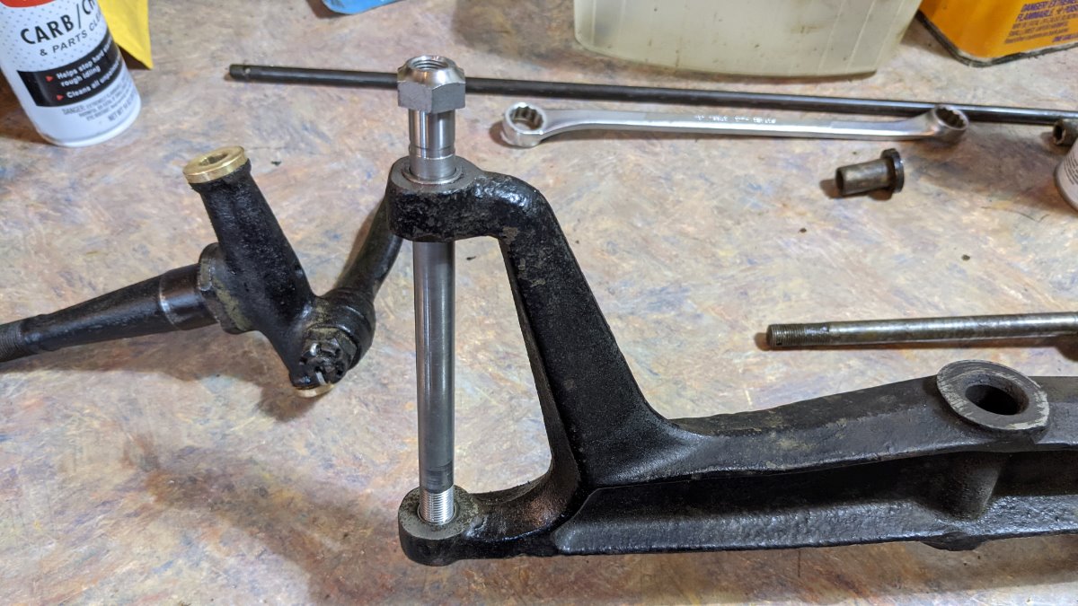

Posted: Sun May 09, 2021 10:33 am
by Mark Nunn
With axle repairs finished, it's time to refit my spindles.

I rebuilt everything on my front axle and spindles. I replaced and reamed bushings, replaced bolts and nuts and aligned everything except one perch. That perch wouldn’t budge no matter what. I will wait until next winter and work on that some more. With everything painted and back on the car, I was hoping for an evening drive last night. But, one tie rod bolt would not tighten sufficiently. I removed it for about the hundredth time (both spindle arms were bent and it took hours of tweaking to get them aligned) and there was a thin wire wrapped around the threads. I assume that was put there to tighten worn threads in the yoke. That’s just one more frustrating thing to fix.
