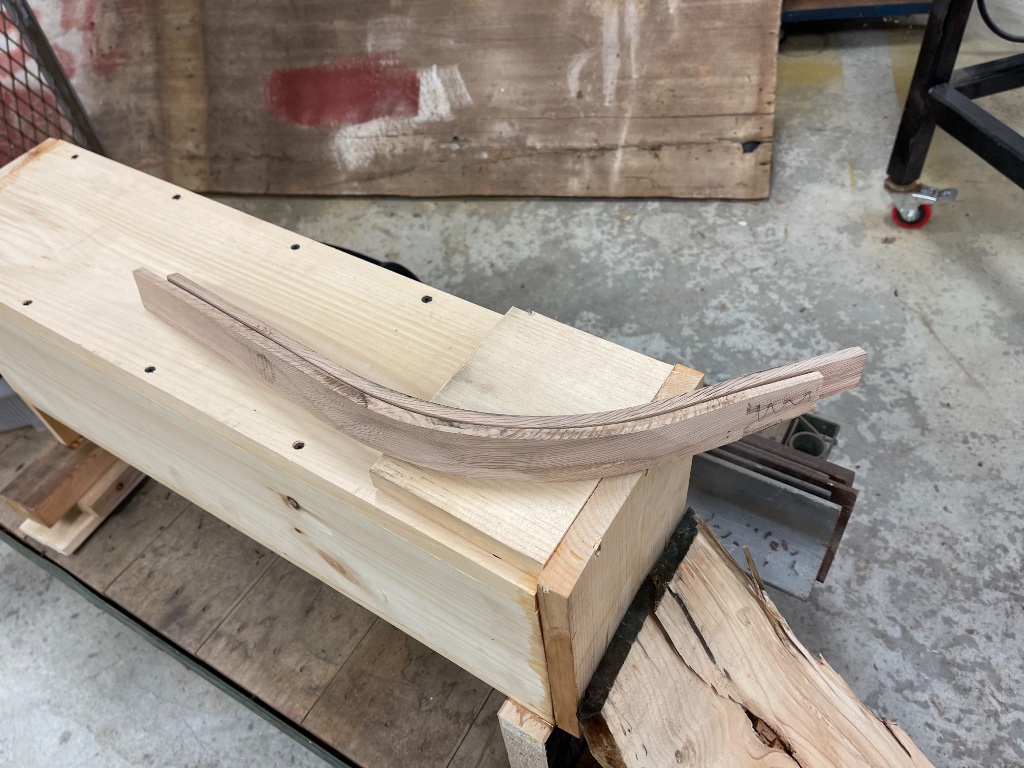

Very nice work. You've got the knack.

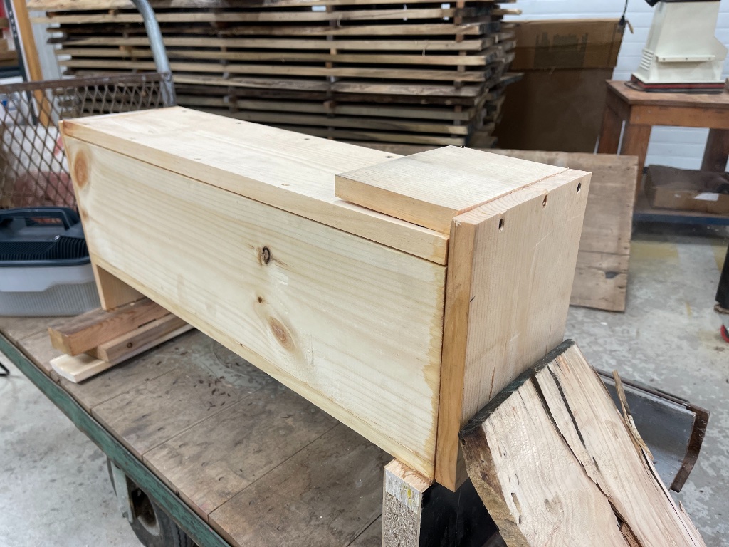

What did you use for the steam generator?
Re: Steam bending today
Posted: Tue May 11, 2021 4:05 pm
by dmdeaton
I use the cheap plastic one that woodcraft sells, Amazon has them for about $50. I used to use a 5 gallon metal gas can and a Cajun burner back when I was building small boats. The cheap one works ok for small stuff

A still boiler would work quite well.
Posted: Tue May 11, 2021 4:19 pm
by Dallas Landers
I use a pressure cooker for steam and pvc pipe for a steam box. Looks good Danny!
Posted: Tue May 11, 2021 4:23 pm
by dmdeaton
Art M wrote:
Tue May 11, 2021 4:14 pm
Art
I like that, I have a 10 gallon still kit I need to put together. Someday I am going to distill water! You guys are great on here! I like the pressure cooker also.

General rule is 1 hour per inch thickness . If you overcook it becomes brittle again. You wanna pick your wood grain wisely also. I used white oak. I had one crack but the boiler ran low on water in the middle of the steam ☹️

If they are old they will be very dry and brittle. You might be able to bring them back to shape though. After rehydrating a little pull and clamp into place then run a heat gun over them. Overbend a little as they will spring back when set free. Any cracks or splinters in a bend zone will split for sure.
